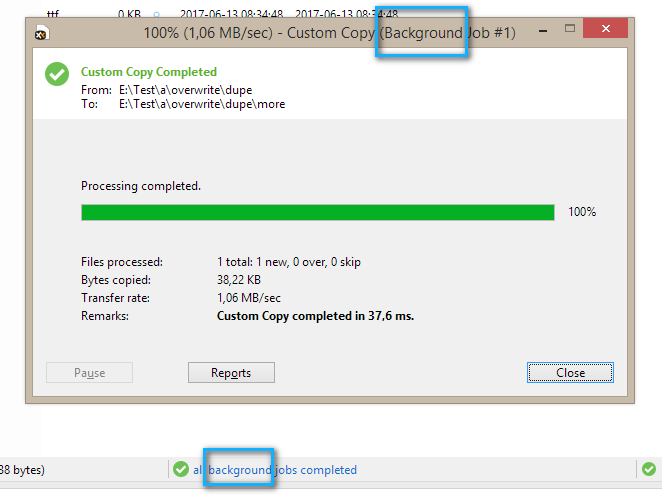

Can you verify that a background operation is really happening? You can tell from the status bar and the summary report:
- 2017-07-17_100805.png (17.9 KiB) Viewed 4046 times
Re: XYplorer not accessible during network copying
It's correctly background.
