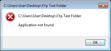

I have a few shortcuts to certain folders on my desktop. In the past I have been able to double-click on any of them and they would open in XYp.
Now when I double-click I get: I tried highend's suggestion above in admin mode. Then went back in admin mode and turned them back on and exited with save. Still the same results.
Thinking maybe it being a shortcut could be part of the problem I copied the entire folder to the desktop. Same error popup when I double-click or try to open in XYp with right-click.
If I open by right-click in WinExplorer it's ok.
Something else. Now if I try to open ANY folder in WinExplorer I now get the above error pop-up. Used to be it would open XYp.
If I open XYp in admin or non-admin modes I am able navigate to and open any folder.
I tried with a ::Fresh instance. Same results.
I have not installed any new programs since this started happening. The only thing I did do was extract a zip version of XYp to a USB thumdrive to use as a portable copy.
I am on Win 7 x64 machine. XYp has worked fine for years in the past on here.
I have not re-booted my machine yet to see if that helps.
Thoughts?
Thoughts?

Re: Uninstalling when XYplorer is set as the default file manager renders all folders un-openable
You didn't. Or you did and turned them off afterwards but did not mention thatThen went back in admin mode and turned them back on and exited with save. Still the same results.
This isn't a mystery. You did the procedure with the copy on the stick for the current user scope (with non-adminHow this happened is a mystery to me
privileges). The registry entries don't lie about this
Switch both back to C:\Program Files (x86)\XYplorer\XYplorer.exeIf I change the "i" references in the registry back to "c" is that enough to get me back to where I was?
