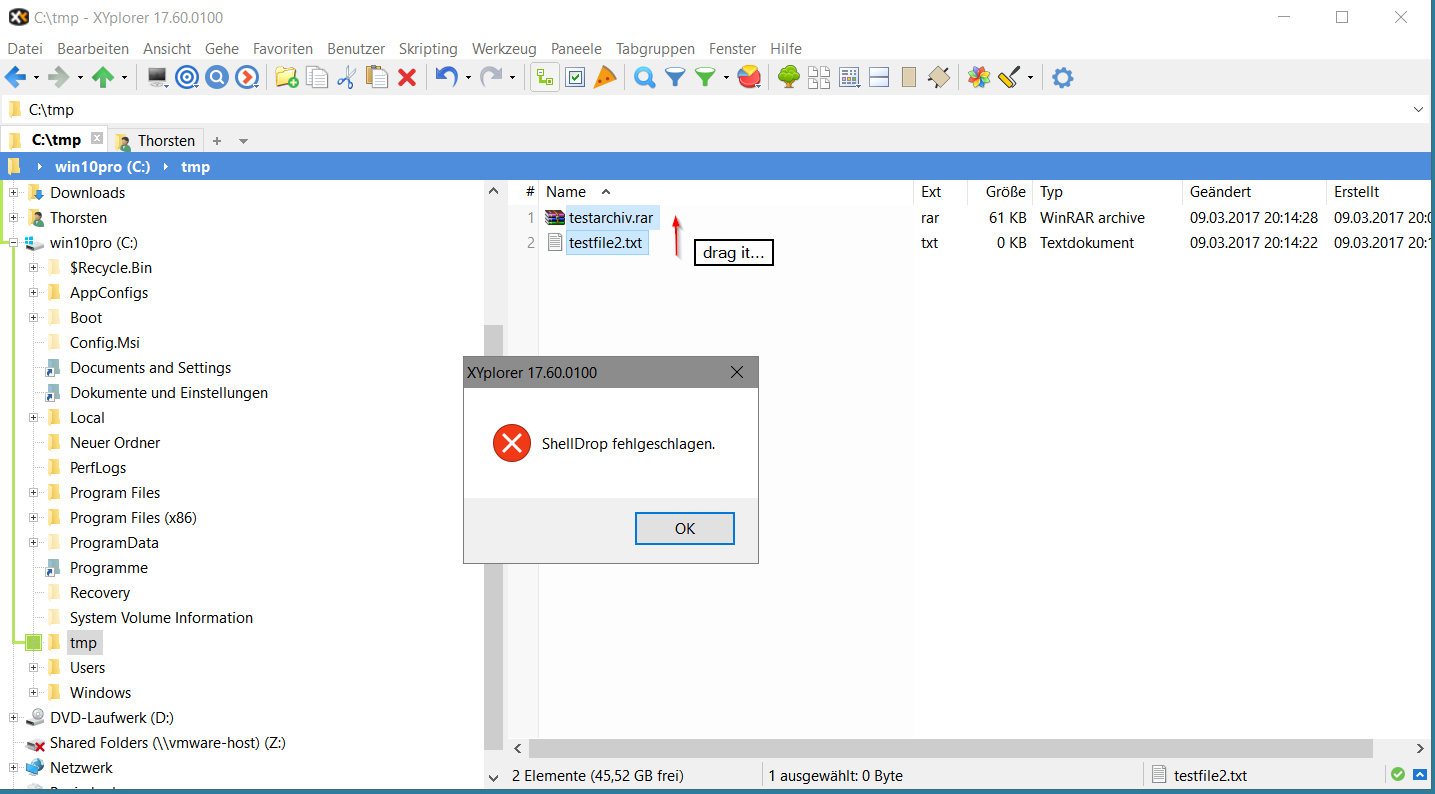

Is anybody of you able to drag a file in the filepane of XYplorer directly into a RAR achive file? See Screenshot. I am not sure if the thread is about this certain functionality (which I miss very much in XYplorer and which work in Windows explorer), or if the thread is about dragging some files from XYplorer into an already opened WinRAR (archive) window. The drop error which is shown in the screenshot happens on my system with every WinRAR version (64 bit or 32 bit) mentioned in this thread. (Windows 10 Pro x64)
Thanks for clarifying.

Posts: 67223
Re: WinRAR and Drag'n'Drop behaviour
Got it, it's a rights thing: XYplorer needs admin rights to make it work.
Whoops, wrong analysis. Actually it is this tweak that makes the difference:
DropOnRarSpecial=1
Change log:
v16.80.0015 - 2016-05-30 14:33
    + Added tweak to support dropping on RAR archives via the RAR command line
      interface. Set the tweak to 1 if the normal shell drop fails (still
      unclear why it fails on RAR archives.)
        DropOnRarSpecial=1
      This will add the dropped files to the dropped-on RAR archive without
thor
Posts: 8
Joined: 15 Jun 2009 13:34
Post by thor »
Thank you!
DropOnRarSpecial=1
works like a charm with XYplorer. No problem with the actual verision WinRAR 5.40 (x64).
