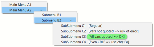

FluxTorpedoe
- Posts: 906
- Joined: 05 Oct 2011 13:15
Re: Add sub-menu support for scripts
Wicked…highend wrote:Can you create multiple nested submenus with your method?
Never needed it before, but here it is, an example with sub-sub-menu and embedded warnings:
— Variables must be quoted when used (else they are resolved prematurely)
— Even XY vars, especially <crlf> (which breaks heredoc menus)
"Main Menu A1"
msg "Main Menu A1";
"Main Menu A2<tab>>"
$var = "foo;bar";
$Menu = <<<#>>>
"Submenu B1"
msg "Submenu B1";
"Submenu B2<tab>>"
$SubMenu = <<<#)))
"SubSubmenu C1 [Regular]"
msg "C1";
"SubSubmenu C2 [Vars not quoted => risk of error]"
msg $var;
"SubSubmenu C3 [All vars quoted => OK]"
msg "$var";
"SubSubmenu C4 [Even CRLF => use chr(13)]"
msg "First line".chr(13)."Second Line";
load $SubMenu, , "s";
load $Menu, , "s";
Cool news!admin wrote:Got an idea for how to do this. Planned for 17.20...
Have a nice day,
Flux
