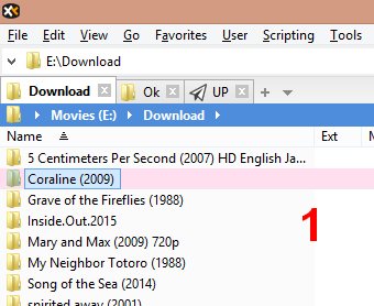

Re: Live Filter - Include Subfolders
why this makes branch view for selected folder instead of current path?highend wrote:Code: Select all
goto tab("get", "path") . "\? /flatfiles";
Execute this:why this makes branch view for selected folder instead of current path?
?goto tab("get", "path") . "\? /flatfiles";
1. The one before you execute it which shows the address bar and the list with the selected folder
2. Another one when the Script debug window is there
maybe "/flatfiles" switch is the reason
for instance using other search switch treats the tab's path not the selected folder

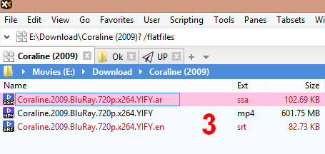

goto "?/types={:Media}"- Attachments
- 1.png (10.95 KiB) Viewed 4632 times
- 2.png (22 KiB) Viewed 4632 times
- 3.png (10.84 KiB) Viewed 4632 times
*baffled*
Can't explain why it chooses the selected folder to make the branch view. The output of the command states that it would just use the
"E:\Download" folder^^ And it works like it should on my system...
It seems you use a version older than 17.00.0008yusef88 wrote:maybe "/flatfiles" switch is the reason
for instance using other search switch treats the tab's path not the selected folderCode: Select all
v17.00.0008 - 2016-07-14 19:22
! Branch View: A Branch View triggered via /flat switch would be applied to
any selected subfolder(s) instead of the folder passed with the switch.
This should not happen. Fixed.Re: Live Filter - Include Subfolders
Yes! that's true.. thanks.
LittleBiG wrote:It seems you use a version older than 17.00.0008Code: Select all
v17.00.0008 - 2016-07-14 19:22 ! Branch View: A Branch View triggered via /flat switch would be applied to any selected subfolder(s) instead of the folder passed with the switch. This should not happen. Fixed.
