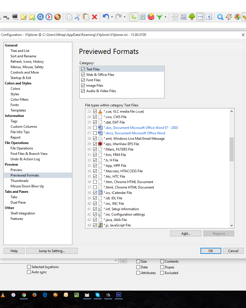

If yes, then uncheck *.doc(x) in the configuration -> previewed formats -> text files
and check it in -> web & office files
it should display the word document now in a kind of word-embedded-view.

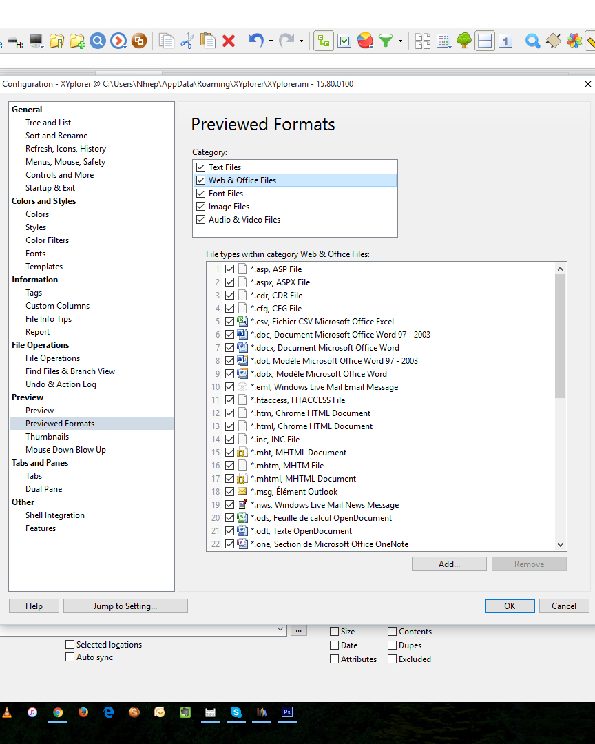

I am talking about the preview tab shown on the fith icon (from right).
I've uncheck in the text configuration and checked in the web configuration.

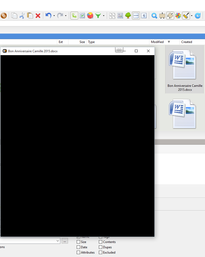

Ok, normally this is Floating Preview.
But, if the file is not supported by FP (which may depend on the viewpoint - my docx files stay in FP and do so in beautiful black) then it automatically opens in Quick File View.

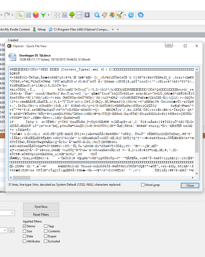

Floating Preview and Full Screen Preview only show previews for anything for which XY can show thumbnails. Your list pane is in a thumbnail mode and XY is not showing contents for the docx which means those previews will not work for it.
It may be possible by installing a third-party program to get this to work but I don't know for sure.
Quick File View does not preview the contents for non-binary files (a docx is a zip file and thus binary). In that case it shows the raw hex view.

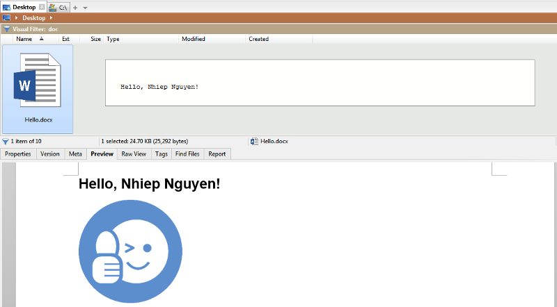

Word documents can be previewed in the Preview Pane of the Information Panel or the extracted text can be shown using Mouse Down Blow Up:
2015-10-20 110018_800.png (39.46 KiB) Viewed 4009 times

Posts: 2724
Re: Word Document Preview
TheQwerty wrote:
How more individual support can get? :tup:

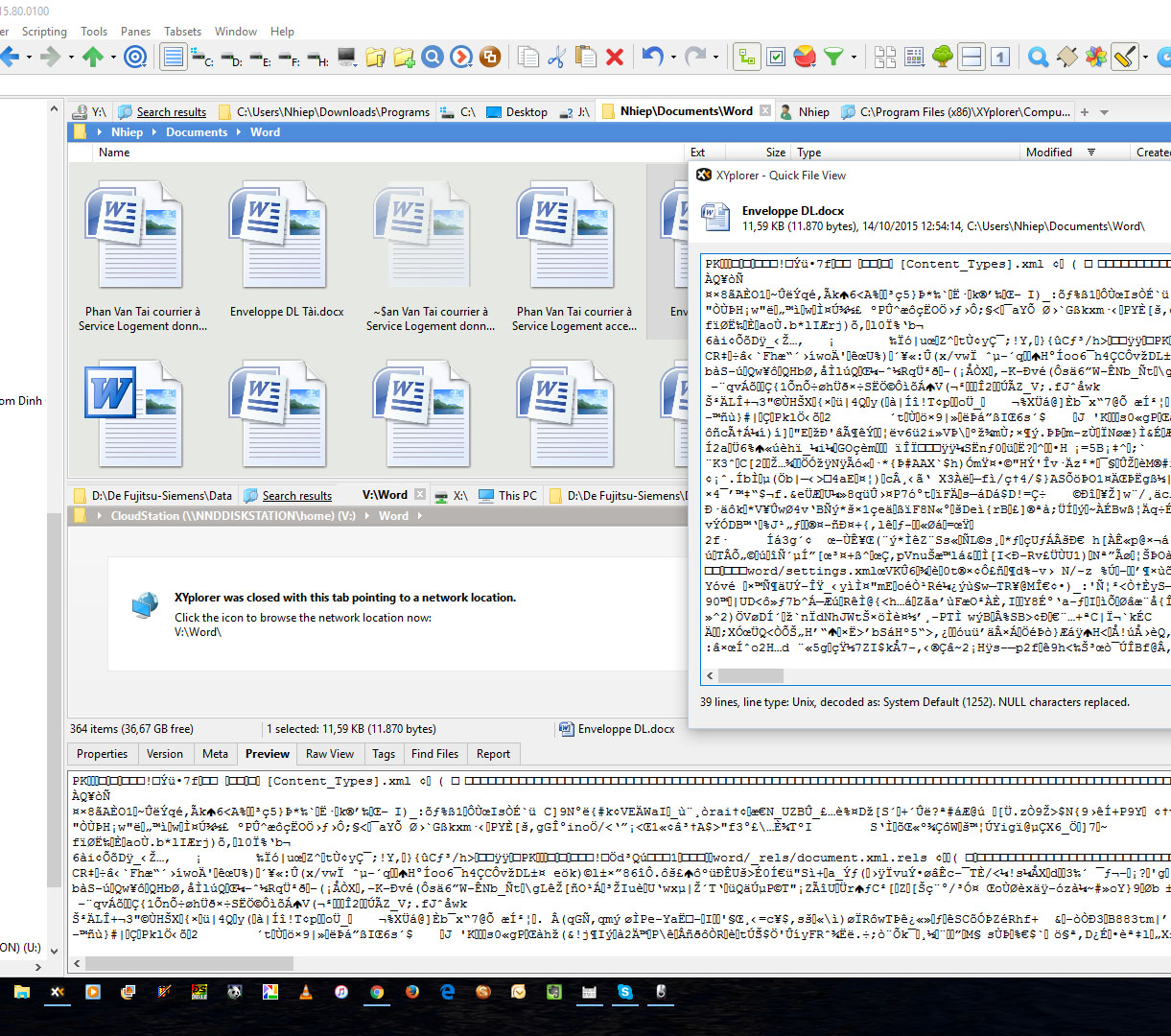

I've tried as you did and the results are not as what you get.
The information pane shows the codes as well as the floating preview turn to Qyuick File View.
