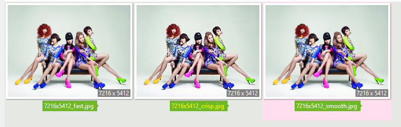

Actually I just made some tests with 7216x5412 thumbnails and they look very good here. I hardly see a difference between the various thumbs qualities.
So, uhm, I suspect the problem is somewhere else. Not enough RAM, maybe?

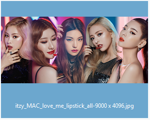

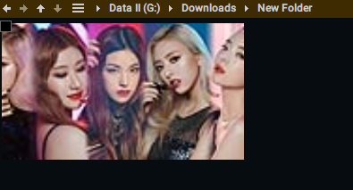

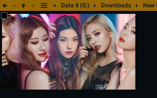

For example the attached one:
with 'crisp': with 'high speed': The 'high speed' actually looks pretty decent here, but I don't want to set it as default because sometimes it produces blurry thumbs (not as bad as the 'crisp' one tho).
I uploaded the full image to mega (too big to attach) so you can maybe reproduce the issue.
Actually, while I was checking the upload, I realized that this jpeg is actually progressive (not baseline) so that might be what's messing with the thumb generator. Since it's taking too long, it might just be taking the first 'low quality version'.
mega.nz/file/KZtyRaAa#bEeozt2LmZWIKoaKffRN98VuYWhy2OW9S6U78V3gZ74To see the attached files, you need to log into the forum.
