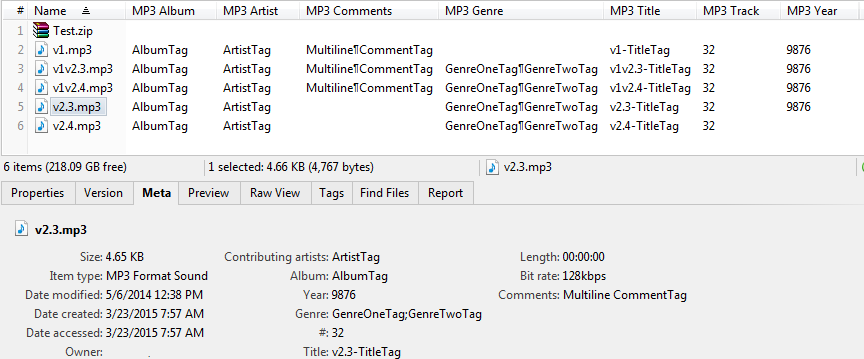

Currently, I use kid3 but just found out that XY's native properties only read ID3v1, ignore ID3v2.3
Hmn, why not support ID3v2?

XY does support ID3v2.3 and sometimes 2.4.
Things have improved only slightly since I explored this last year:
Still XY claims Preview "cannot decode" MP3s with ID3v2.4 (at least here where I have no codecs installed).
There remain differences between the Meta tab and the columns:
v1.mp3; v1v2.4.mp3; and v2.4.mp3 only show Length & Bit rate in the Meta tab
v2.3.mp3 shows all fields (including comment) in the Meta tab but as you can see its MP3 Comments column is empty.

This goes back to the screenshot/post I mentioned earlier. I believe <prop #mp3.Comments> only pulls comments from the ID3v1 field, so if you only set the comment in ID3v2 XY won't see it.
