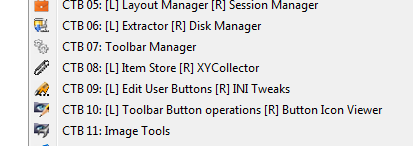

With the script "LaycatTools" you can make and save new toolbars and load them from a list. You can save and load Layouts, Columns, and Catalogs as well http://www.xyplorer.com/xyfc/viewtopic. ... ls#p107403 The script itself is a little further on in the thread from where the picture is posted.
There's another script out there that may be more like what you want that provides an executable listing of all the current CTBs (with their icons) called EditUserButtons.xys, but can be used to run them with a minor change as well. http://www.xyplorer.com/xyfc/viewtopic. ... ton#p90688 A portion of the listing looks like this...

LayCatTools will simply save the toolbar information (in exactly the same format used in the XYplorer.ini) in a separate txt file. The toolbar txt files are named and can be saved and loaded any time. I wanted to make it as easy as possible by having separate files for each toolbar saved (e.g., normal, default, File Ops etc.). So they'd be handled in the same manner as layouts, columns and catalogs. Since they include the custom buttons, I'm not sure how shareable with others it would be.
I was thinking last night that I'll work on a toolbar script which will utilize portions of your nice script for editing a user button (EditUserButtons) and combine it with some of LayCatTools features such that a user can build toolbars and save them and load them in the same manner as I mentioned, but these different toolbars will be displayed vertically as in the capture above and hopefully not affect the "actual" toolbar in XYplorer. Though as far as building one would probably have to make sure their "normal" toolbar is saved and then modify or make a new toolbar(s), save it with a new name, and reload their "normal" one.
