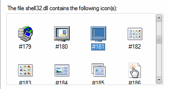

XY seems to retrieve the wrong icon ID in sheel32.dll
i.e: %SystemRoot%\SYSTEM32\shell32.dll /181 is computer icon, however, XY shows as DVD icon (ID=222)

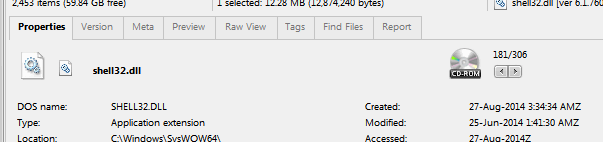

What OS are you on? On my system 181 == cdrom icon.
aside from that, Here's the explanation.

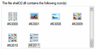

#181 is the icon's ID in shell32.dll. But XY uses the ordinal position (index) of the icon.[/size]
Though shell32.dll has icon IDs up to #63011,there are actually only 306 icons in total when counted.
Here's what you should do:
Start counting from the first icon, and you'll see that the 181st icon (not ID #181) is indeed the icon you see.
Open XY's property info pane for shell32.dll, and increase the icon counter to 181 (this index number is what XY uses, not the ID) I hope I explained clearly!

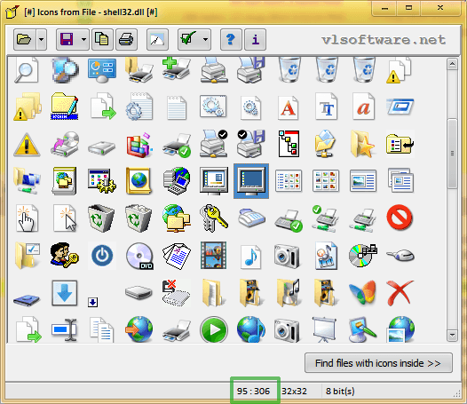

you can click-and-hold the arrows there...binocular222 wrote:Browsing icon ONE-BY-ONE in XY properties panel is impractical.
found a solution: http://www.vlsoftware.net/icons-from-file/download.html
selected icon's index is shown in the statusbar as <index>:<total> (hilited in green)
It's an innosetup installer, extractable with Universal Extractor, and the program itself is portable.
It's initially in Ukrainian, select the green tick button in the toolbar, pick the first menu item, and choose english.
It also tries to go online, probably to check for updates, but I ran it inside Sandboxie...

Thanks, that works
