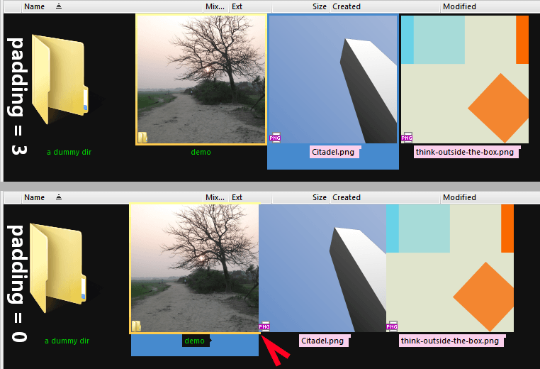

If folder thumbnails are enabled, then the yellow border/background that denotes folders actually spill outside the allowed gridspace of a thumbnail.
This is clearly visible if padding < 4.
See how citadel.png & think-outside-the-box.png have correct padding, but citadel and demo folder thumb do not.
top:padding=3<br />bottom:padding=0
top:padding=3
bottom:padding=0
And in the bottom screencap (padding=0), also note that the yellow BG is overlapping with the column headers (in addition to the overlap pointed by the red arrow)

more: in addition to ^ , if Selection Style is set as Windows Theme, then the image/filename can exceed selection borders when padding is lowered.
padding = 0 here.

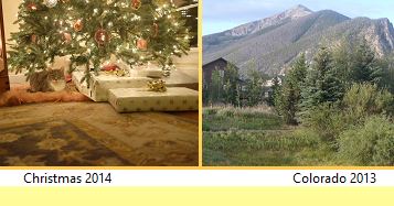

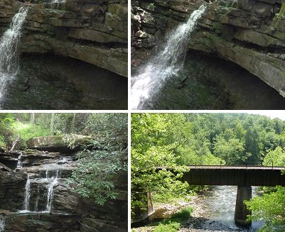

In Sammay's first post, his screen capture that shows absolutely no gap or padding side-to-side between the thumbnail images (I'm not referring to the folder thumbs, but the image thumbnails in the second row of thumbs). I have padding set to "0", but I always have a gap between the thumbnails (see capture below). Is there something else out there, either inside or outside or XYplorer I'm missing, that may be affecting this padding. In some situations, I'd like to achieve a zero gap between the thumbnails on the side and if I have captions off, also on the top and bottom. Maybe I should have started a new thread, but since Sammay had posted a picture of a thumbnail view showing absolutely no gap or padding between his thumbs I figured I'd use this old thread.
Capture is with padding at "0" and no captions.
Thanks for any help.
Ken

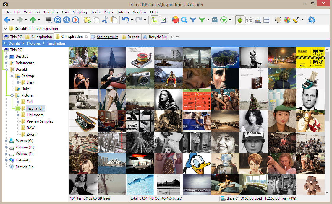

Padding=0 should work. Take care that Style=Plain, too.

Wow, something very odd is going on. I experimented further and discovered setting the padding in XYplorer.ini to "-2" results in having no gap between thumbs as seen below. I first set it to "-1" and saw that the gap decreased. Of course the padding value in Configuration still says "0". This is the case for both my desktop with Windows 10 Pro and my laptop with Windows 7 Home. So I wonder what else is affecting this, language, locale, fonts, font spacing, styles. I wonder if anyone else have this issue? Thanks.
padding set at -2 capture.JPG (38.97 KiB) Viewed 3678 times
