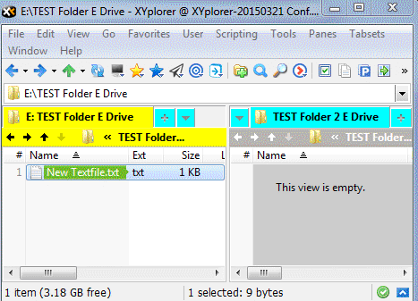

I'm resurrecting this old post since it is related to my orig question. I know depending on what I want to copy, sometimes I need to be in User Mode others Admin Mode.
This one has me confused though. Here's a sample video.
I'm in user mode and try to copy a file from one pane to another. Since I am in user mode I get a permissions pop-up. Even when I say OK, the copy doesn't happen. Note the progress indicator in the bottom right.
Anything I can do so when I give XY the permission the copy happens?
Thanks
Re: Admin Mode Indicator??
Posted: 27 Mar 2015 11:21
Tested it, got the same prompts, but here it worked. I copied a file to C:\ using XYcopy without any issue.

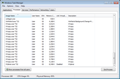

Sill trying to figure out why I'm not able to copy in user mode after giving permission with the pop-up.
Took a look at Task Manager and found I had multiple instances of XYcopy.exe showing.
I'm assuming the reason there were so many showing is I closed XY while the copy was still trying to complete. Correct?
I have XY set to save settings on close.
What happens when there are multiple XYcopy instances running at the same time?
Anyone have any suggestions of what Windows settings I can take a look at to allow XY to copy in user mode after giving Admin permission with the pop-up in User mode?
Posted: 28 Mar 2015 16:41
This should not happen at all -- even if you close XYplorer.exe. Cannot explain ATM.
