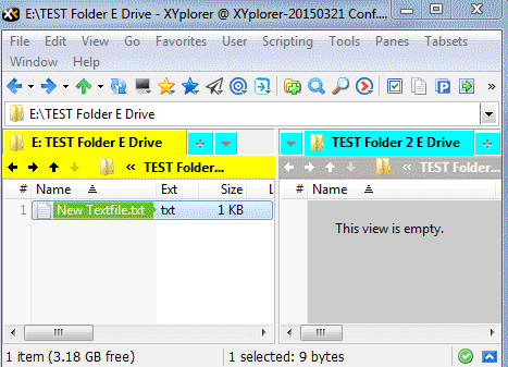

I'm resurrecting this old post since it is related to my orig question. I know depending on what I want to copy, sometimes I need to be in User Mode others Admin Mode.
This one has me confused though. Here's a sample video.
I'm in user mode and try to copy a file from one pane to another. Since I am in user mode I get a permissions pop-up. Even when I say OK, the copy doesn't happen. Note the progress indicator in the bottom right.
Anything I can do so when I give XY the permission the copy happens?
Thanks
Posts: 66634
Re: Admin Mode Indicator??
Tested it, got the same prompts, but here it worked. I copied a file to C:\ using XYcopy without any issue.

Probably should have included I'm on Win7 Pro x64, running MSE and I have XYcopy.exe and XYplorer.exe (full paths) in the MSE excluded processes.
Anyone else running with MSE seeing this and have any suggestions? It's something else other than XY. Just having trouble figuring out what?
Thanks

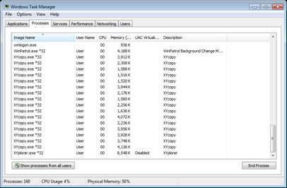

Sill trying to figure out why I'm not able to copy in user mode after giving permission with the pop-up.
Took a look at Task Manager and found I had multiple instances of XYcopy.exe showing.
I'm assuming the reason there were so many showing is I closed XY while the copy was still trying to complete. Correct?
I have XY set to save settings on close.
What happens when there are multiple XYcopy instances running at the same time?
Anyone have any suggestions of what Windows settings I can take a look at to allow XY to copy in user mode after giving Admin permission with the pop-up in User mode?
Posts: 66634
This should not happen at all -- even if you close XYplorer.exe. Cannot explain ATM.

admin wrote:This should not happen at all -- even if you close XYplorer.exe. Cannot explain ATM.
Thanks for looking into it when you get a chance.
Since no one else is commenting it must be something specific to my set-up.
If there is anything additional I can provide let me know. It gets a bit frustrating at times having to close XY if I'm in User mode and re-open in Admin mode to copy or move files.
Posts: 66634
If XYcopy is really the problem you could do the copy in the foreground: Untick Configuration > File Operations > Background Processing > Enable background processing
