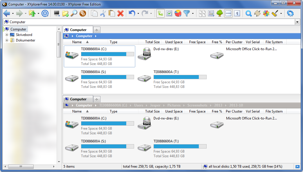

I just installed XYplorer for the first time and played around with it a bit (a few minutes), and it looks very promising!
But suddenly the main menu bar was gone:
I have searched everywhere to get it back, including in the settings and the toolbar, but I could find no place to re-enable the menu bar. What did I do wrong and how do I get it back?
It seems like a bug to me, as it is so unintuitive to get it back. But of course, it could be a feature that I just need to learn how to control.
I am using WIndows 7, 64 bit.

Alt+Up
Maybe you just rested your hands on the keyboard...

Thank you so much, both of you! It worked!
And now that you mention it, I do remember pressing the arrow keys around that time, apparently with the Alt key too for some strange reason.
And I too believe that one solution could be to make the shortcut a little more complicated. Maybe just Alt+Shift+Up so it is still easy to use (because it seems quite useful to turn off the menus when you know how to get them back).
But also, could there be some GUI way to get the menu bar back, so that it doesn't completely depend on a keyboard shortcut?
I just got another idea: Pressing F10 is a standard way of activating the menus in Windows. I tried that when the menu was gone, but it didn't work. Unfortunately, I can see that this shortcut seems to be assigned to another function in XYplorer.
But pressing the left Alt key alone is another standard way of activating the menu bar. Maybe XYplorer could automatically show the menu bar if it is hidden and Alt is pressed and released? Either show it temporarily (hiding it again when it loses focus) or "permanently" (like pressing Alt+Up). That would be intuitive for people like me that know that pressing Alt activates the menu. And then there could be a menu item in the View menu to turn on the main menu bar "permanently" again: View | Menu bar (with a toggle check mark like the Auto-Refresh item), even showing its shortcut (which is now Alt+Up). To me, that would be intuitive. If that was implemented when I used the program the first time, I would have found out about the menu bar show/hide thing myself and I would even have discovered the shortcut because it was mentioned in the menu.

I added an experimental tweak:
+ Tweak to toggle the main menu by ALT:
HideMainMenuToggleByAlt=1
