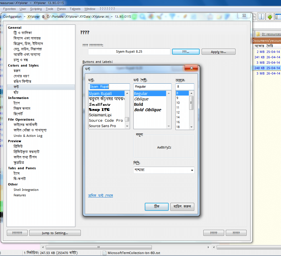

Many places cannot render bangla correctly (menu bar, buttons). What should I do to make them visible?
I believe it has something to do with the OS, it happens with other complex languages, such as Korean.

So I wanted to see how the ??? strings look, and installed the Bangla lang pack. And promptly had a shock:
Apparently, a special class of strings is stilll shown that way, even though Windows' own strings are clearly translated.
Oh, what do I do?

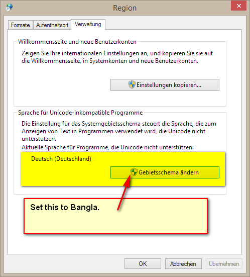

See attached screenshot (Control Panel / Region Settings, or so -- I only have German Windows here). If this does not help, could you send me your Bangla LNG file for testing?

Windows 7 doesn't have Bangla/Bengali in System Locale ( believe that's what you pointed at). Does Win8?

Oh no, now I see what's the problem. There is no Windows code page for Bangla! Therefore it will not work. :cry: I'm sorry for the work you did in vain.
