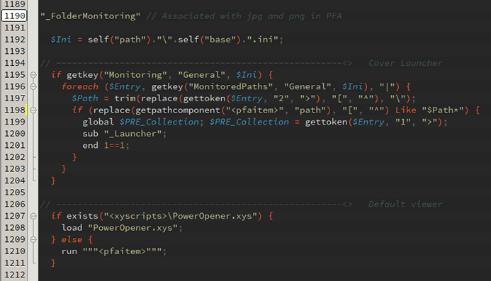

Here's a screenshot of the way it looks (with my color definitions).
