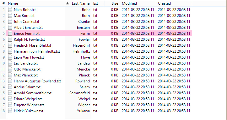

Here's something that might be useful one day. A column to sort names by the last name:
The script:
$base = getpathcomponent(<cc_name>, "base");
$lastname = gettoken($base, -1);
return $lastname;
Maybe you can share your favorite custom columns as well...

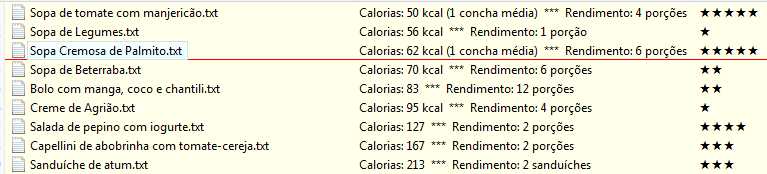

Here I am organizing cooking recipes
-they are written as plain .txt;
-Custom Columns are reading paragraphs 3 and 5, containing 'calories *** portions served', respectively.
-with proper left-alignment, they can be sorted 'by calories'. :biggrin:
-note the use of 'extra column' with rating stars.
Caption: Calorias *** Porções
type: script
script:
$a = readfile("<cc_item>");
$b = gettoken("$a", 1, "<crlf>") . "***  " . gettoken("$a", 5, "<crlf>");
return "$b";
format: text
item type: files
filter: txt
___________
To get the fine line underlining your active file: 'tools > customize list > highlight selected rows'; you may then want to customize it under 'tools > configuration... > colors > list > selected rows', also (un)ticking 'underline selected rows' at 'tools > configuration... > styles'.
