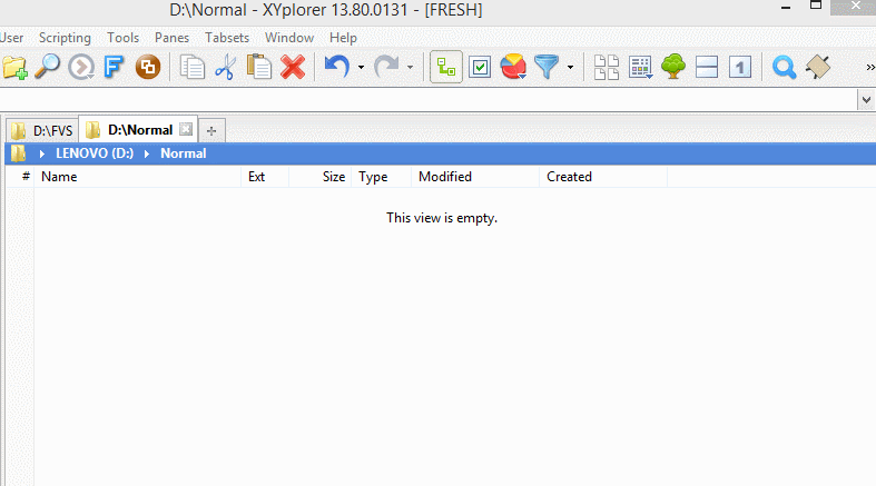

Ok, on a fresh installation. Just to keep the GIF short, I closed some tabs and navigated to some folders - FVS and Normal.
Toolbar customised to show FVS icon and the only setting changed was that I unticked Column Layout under Styles>Remember list settings per tab.
1. I add the column accessed to the folder FVS and save the folder view
2. Navigate to the normal folder and the Accessed column is visible there.
3. I remove the column Accessed from the Normal folder tab
4. When I navigate to FVS tab, the column Accessed has disappeared as well
5. Doing a restore folder view restores it
6. The thing I didn't capture in GIF is that restoring the FVS also restores the column in non-FVS

Re: FVS columns are displayed in non-FVS locations
What you are probably not aware of: Tab layouts have precedence over FVS. FVS sets in when you change location within a tab.
