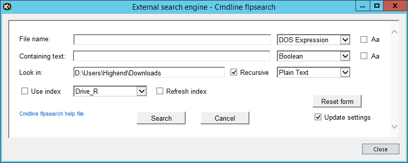

I've created a script that let's you use an external search engine (that is a bit more flexible in terms of boolean / boolean regex searches when it comes to the content of files).
Atm it works with Agent Ransack, File Locator and it's commercial version File Locator Pro.
File Locator Pro's boolean regex is really a powerhorse^^
Prerequisite:
- Current beta version of XY (with support for paper folders)!
- Be in the folder that'll be the base for your search
It's not a necessity but the corresponding field is prefilled with the current path...
To set the script up, run it once, quit it and then edit the corresponding .ini file "<same name as the script file.ini>"
(in the same folder as the script).
"SearchEngine=" is the minimum requirement! If you are using FileLocator Pro and want to use indexed searches,
you need "IndexPath=" as well...
A screenshot of the search dialog window (XY side): Current version:
v2018.05.12 Build 10.08 Older versions:
v2018.03.04 Build 10.07 v2015.06.26 Build 10.06 v2014.06.29 Build 20.31 v2014.06.29 Build 17.12 v2014.03.07 Build 21.16 v2014.03.05 Build 09.23
