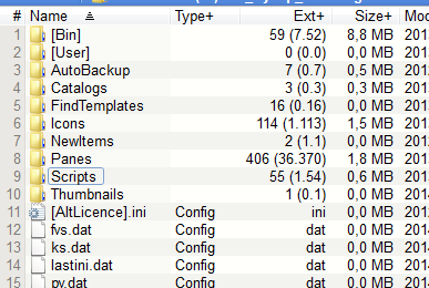

FluxTorpedoe
- Posts: 904
- Joined: 05 Oct 2011 13:15
Re: Folder File Count Column?
Hi'
1. Ext+
- For folders, displays: FolderCount (NbSubFolders.NbFiles)
It's pretty stripped-down because I found it the easiest to interpret — fastest to read than e.g. Total:45(Dirs:3 / Files:42)
- For files, it depends on audio or images, etc. (WorkInProgress)
Edit: Much faster code for folders (less disk access)[/size]Old code was:[/size]
2. Size+
returns the total size of folders or files always in MB (same as above: after some trials, fastest to interpret on screen for me)[/size]
Hope this helps,
Flux
Edit: didn't see Don posted while I was writing... He's too fast!
I'm in a rush, so no time to detail right now, but as a matter of fact those were the first CCs I created! So here they are, they're still a work in progress but it should give you something to tinker with:iycgtptyarvg wrote:1. A column named Tot Files which counts the amount of files in the directory.
2. A column named Size which counts the amount of bytes in the directory or file.
1. Ext+
if <cc_isfolder> {
$NbDirs = foldersize(<cc_item>, "<d>");
$NbFiles = foldersize(<cc_item>, "<f>");
return $NbDirs+$NbFiles." ($NbDirs.$NbFiles)";
} else {
if ("jpg;jpeg;png;gif;psd;tif;tiff;bmp;ico" Like "*<cc_ext>*") {
return property("#image.dimensions", <cc_item>);
} elseif ("mp3;wav;ogg" Like "*<cc_ext>*") {
return property("#audio.length", <cc_item>);
} elseif ("wma;avi;mkv;mp4;divx;mpg;mpeg" Like "*<cc_ext>*") {
return property("#27", <cc_item>);
} else {
return <cc_ext>;
}Code: Select all
if <cc_isfolder> {
return report("{count}", <cc_item>)." (".foldersize(<cc_item>, "<d>").".".foldersize(<cc_item>, "<f>").")";
}2. Size+
if <cc_isfolder> {
return formatbytes(foldersize(<cc_item>, "<r>"), "MB", 1);
} else {
return formatbytes(report("{size}", <cc_item>), "MB", 1);
}Hope this helps,
Flux
