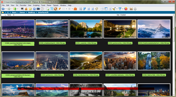

Whenever I'm in thumbnails mode or tiles view, the most annoying thing is the distance that each mouse scroll click moves. Is there any ways to adjust that? It's especially annoying in thumbnails because for every scroll, it's very likely the next row of thumbnails get move to far and it gets partially covered. Basically make it "smoother" or something.
EDIT: Like this below. Before and After 1 scroll mouse "click". Pay attention to the red highlight.
Also someone need to answer me but why does XYplorer's in thumbnail view so glorious?

I think this is standard behavior. One scroll click = one page. Same as one notch with the wheel.
What?Enternal wrote:Also someone need to answer me but why does XYplorer's in thumbnail view so glorious?

"Smoother" scrolling was asked before (can't find the exact thread tho), like in WE. Unfortunately XY is designed like this, and the first row/line has to be perfectly on top. Don can confirm and said he wasn't going to change this unless with a major effort. However changing this and the travel-on-screen-per-scroll (maybe depending on the List view) would give what you expect. And I suspect old and new users would find it extremely natural and would give the feel of a "native" interface, so to speak.

Haha I meant that XYplorer look so great. It's just you made such a great looking UI and in thumbnail view, the thumbnails of all the images together with the great UI just makes it awesome.admin wrote:I think this is standard behavior. One scroll click = one page. Same as one notch with the wheel.
What?![]()
Anyways, yes my problem was not what Borut described. Mine is simply more on how much distance it scrolls. What's odd is if I click the arrow on the scrollbar down, it moves less than with the mouse 1 notch of the scroll wheel. Therefore I always end up not using the scroll wheel on the mouse for this very reason. However, even the arrow I think cause the thumbnails to scroll down too much but still better than the scroll wheel. Best example is by animated gifs heh.
XYplorer. You can see how it's blocky with the movement. That can get in the way of viewing through the thumbnails since you scroll down to take a quicker look and boom! It's way on top now and mostly covered. Here is another gallery app that I'm also scrolling per notch on the scroll wheel. You can see that it's smoother. If you grabbed it by the scrollbar, it becomes even more smooth.

Oh! So this is the reason. So it's not possible at all to "hey XYplorer, every 1 notch that a user scroll, take that divide it by 4 and roll that distance!"Marco wrote:"Smoother" scrolling was asked before (can't find the exact thread tho), like in WE. Unfortunately XY is designed like this, and the first row/line has to be perfectly on top. Don can confirm and said he wasn't going to change this unless with a major effort. However changing this and the travel-on-screen-per-scroll (maybe depending on the List view) would give what you expect. And I suspect old and new users would find it extremely natural and would give the feel of a "native" interface, so to speak.
PS: all the wallpapers from The Paper Wall, huh?
Of course programming is all different... haha.
And actually the wallpapers came from interfacelift.com!
EDIT: Now that I look at it, I never noticed that the top row ALWAYS perfectly on top! That's a surprise! So that's the reason why smooth scrolling is not really possible? If only it is possible for XYplorer to scroll to the next roll with the next roll on top. So basically if we have 4 rows of thumbnails, every notch moves down by 1 roll. That should somewhat emulate the smooth scrolling for thumbnail view at least. Otherwise, currently with my view, it starts from row 1 and then suddenly jump down to row 3.

So would it be possible for it to scroll down row by row instead of row down to the very last row that's visible? Or is that still pretty difficult and require a lot of code change?

Ah. Just realized that I really need to pay attention moreadmin wrote:Click the scrollbar arrow to do that.
