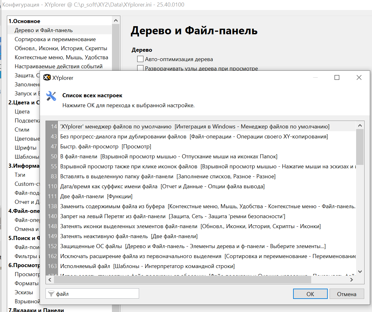

1) I have found new tooltip to «Appl&y to files only» in F9..Find Files & Branch View/Visual Filters, but i can't find the translation «Appl&y to files only» that is «Применять только к файлам»
The search in configuration finds only Применять только к фа, but after entering letter й search can't find for example Применять только к фай

1) Yes, string "Применять только к файлам" is in a lng file. But it is not searchable in configuration (by filter after button Jump to Setting) if string contain letter й, for example word файл is not searchable, in other words, the letter й is searched incorrectly.
String with the letter Й is not foundable even if I copy it to the filter directly from the configuration using Ctrl+Right click.
2,3,4 Thanks. (in 4 was an unexpected location of tip - first section of status bar)

Strange, can't explain. й works fine in live filter and file search. Must be some error in the code page.

2 screenshots (after windows 10 restart due to a possible code page error) XY_25.40.0100 and XY_26.30.0412
I can't explain too.
- Posts: 66191
Re: Russian
Yes, you were right!
It's a recent bug (since v26.30.0206 - 2024-08-21 14:38). Fix coming...

now (in ...413 version) works!
