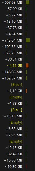

I use a custom column to show more color distinct bars, but I like the idea of the different background colors.
I create the bars with this
$size = "<cc_size>";
$min = 3;
switch (true){
case $size == 0: return ''; // draw nothing
case $size < 1024: return '>draw.bar ' . 100 * $size \ 1024 + $min . ', 004400'; //smaller 1KB
case $size < 1048576: return '>draw.bar ' . 100 * $size \ 1048576 + $min . ', 227711'; //smaller 1MB
case $size < 1073741824: return '>draw.bar ' . 100 * $size \ 1073741824 + $min . ', 556600'; //smaller 1GB
case $size < 10737418240: return '>draw.bar ' . 100 * $size \ 10737418240 + $min . ', AA4400'; //smaller 10GB
case $size < 107374182400: return '>draw.bar ' . 100 * $size \ 107374182400 + $min . ', 881111'; //smaller 100GB
default: return '>draw.bar ' . 100 * $size \ 1099511627776 + $min . ', FF0000'; //from 100GB to 1TB
and the output is like this
- bars.png (4.53 KiB) Viewed 3692 times
which is difficult to differentiate in very small bars.
Is it possible to change the script in a way that I could paint the background of each size group with a different color?

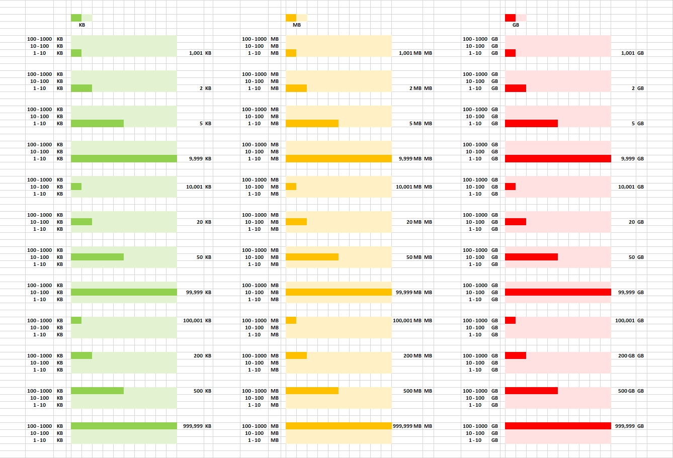

Hello everyone,
I am not using this feature.
But I still wanted to talk about my opinion on this subject.
Also, I've been pretty busy lately, so I haven't been able to read through the whole thread, I just skimmed the charts.
Sorry if I repeated the same idea.
I think that the graph to be added should not be complicated since the numeric quantities can already be displayed.
I think using too many colors in the same bar also creates confusion.
However, if we use only one color, the graph cannot give us enough information instantly.
So, I think using colors for units such as KB, MB and GB rather than using them for numerical sizes will help us to have an immediate knowledge of the size.
The pictures I added will best explain the use of colors.
Because as I mentioned before, I use "Google Translate" because my English is not good.
There is something I would like to explain regarding the pictures I sent.
In the pictures, I showed the sticks as 10 pieces, but that was just for clarification.
In summary;
Display of sticks as one piece.
Transfer of the size measure to the graphic in linear proportion.
As in the pictures; Using different colors for KB, MB and GB units.
This way we don't need to represent the file size logarithmically.
So, the comparison of two sizes in the same unit with each other can also be perceived visually.
I created 2 separate templates.
One is very simple.
The other is a little more detailed.
- Size Bars (Detailed).jpg (556.73 KiB) Viewed 3662 times
![Size Bars [Simple].jpg](./download/file.php?id=18724&sid=ed2cf9a02663f9d425f40dd66bf929e1)
- Size Bars [Simple].jpg (142.01 KiB) Viewed 3662 times
I hope you like one of them and find it worthy to apply.
Thank you for your interest.

noembryo wrote: ↑08 Dec 2022 13:33
You seem to be using the modified version of the script from the bottom of this page:
viewtopic.php?p=155469#p155469
If instead you look at the version I posted, you'd see it has 2 hex colors listed, per size group, ie. foreground background, which would look as such:
- 2022-12-09_104348.png (1000 Bytes) Viewed 3632 times
