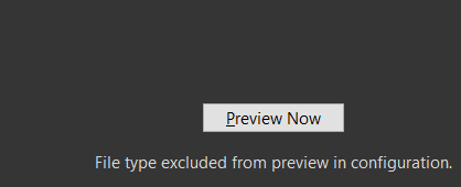

- Posts: 1398
- Joined: 24 Jan 2021 12:27
- Location: Germany
Re: Preview .msg files "No Preview Available"
Yes, this gives me the following screen in place of the preview
I have to press Preview now to get the preview.
If I add it as User defined preview handler it works direct.
- Posts: 14991
You need to have it enabled in "Office Files"
