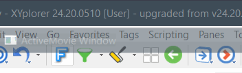

Posted: 31 Mar 2023 06:45
by jupe
My issue looks nearly fixed, except I now get a quick flash of a "Active Movie window" opening up every time I open the preview pane/panel or switch files with it already open, it was hard to catch an image of it because it flashes so quick, but I caught the screenshot below, if you look closely you'll see it. I am not sure if this is just happening since the error msg I purposely invoked, but it now happens always in all instances, I'll need to restart OS soon to find out but can't currently. The other issue I am now seeing is that the video is not taking up the whole video frame there is a black border, but the video outer frame looks the correct dimensions.
There is also a weird situation where the window controls get shown over the video on mouseover, in the second screenshot you can see an example of this which also illustrates the actual playback size and the frame size being different.
I think all the issues will go away if you can stop that ActiveMovie Window showing up.
I can also get the whole window shown but still embedded in XY panel/pane by using the controls:

Re: Preview of some video files is not working
Posted: 31 Mar 2023 16:59
by jupe
Looks really good in in .0511, everything from my last post is fixed :tup: , but just for completeness I should mention that occasionally with the preview pane/panel already open I select a file and the video frame doesn't show, unselecting/reselecting the file works most times, or sometimes it requires selecting a different file and coming back to the original one, or sometimes toggling the preview pane on/off a few times keeping the file selected. I rarely use video preview so it may have always been like this on my HW, I have an old GPU.

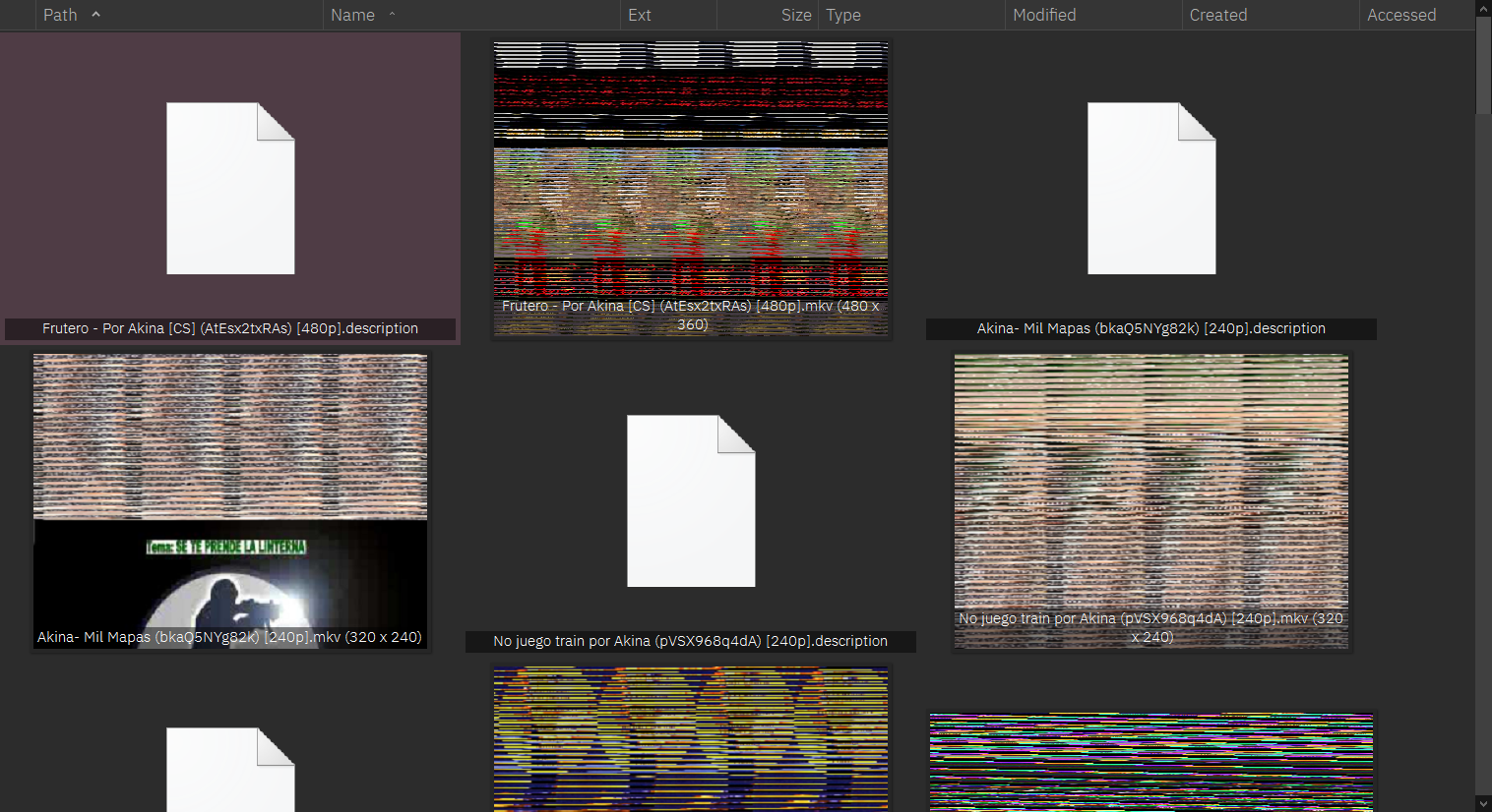

Posted: 28 Jun 2024 07:08
by 1024mb
I have a problem with thumbs again. This time I've noticed it only happens when using branch view (I only use the "files only" mode). If I browse each folder the thumbnails are created without problems. Once I get this error all the thumbnails created so far are messed up, see pic.

I tried setting PreviewEarlyFactory from 0 to 1 and 2 to no avail. Offending file is 806.02MB big.
Posted: 28 Jun 2024 09:14
You don't get this error when you list folder F:\Videos\youtube\Filmagem X in normal (non-branch) view? Really? Try View | Caches | Refresh Thumbnails in that folder.
Posted: 28 Jun 2024 11:08
by 1024mb
admin wrote: ↑28 Jun 2024 09:14 You don't get this error when you list folder F:\Videos\youtube\Filmagem X in normal (non-branch) view? Really? Try View | Caches | Refresh Thumbnails in that folder.
Yep, just tried it and the thumb was created without problems.
Posted: 28 Jun 2024 12:10
Maybe it was a delayed error. What's the file right before that one (when doing it in the branch view)?
Posted: 28 Jun 2024 22:04
by 1024mb
admin wrote: ↑28 Jun 2024 12:10 Maybe it was a delayed error. What's the file right before that one (when doing it in the branch view)?
Tried to reproduce now and it's not happening anymore, I haven't even rebooted so I don't know what triggers it.
I've tried with other files and most of them work without problems, but some show the same error message as before.
EDIT: Updated K-Lite to latest beta version and it seems now it doesn't happen anymore, will see if it happens again.
