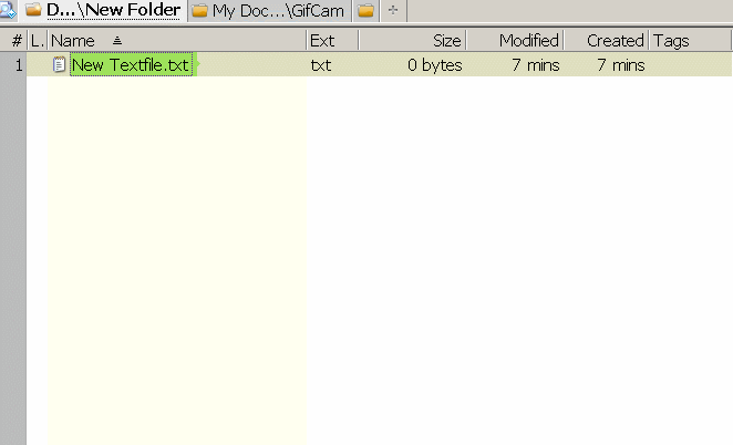

admin wrote:Could somebody post an animated GIF (using e.g. GifCam) of the exact place and moment of the crash please?
Here it is. Happens on left and right drags.

Posts: 66193
Re: Drag and drop crash with 12.90.0004
So it's not only when crossing the border to a new window / control!
I will now setup a debug environment... cu tomorrow.
PS: also when dragging from Tree, right?

admin wrote:So it's not only when crossing the border to a new window / control!
Yes, just initiating a drag does it. And also from tree, same exact message.
