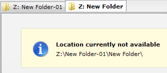

To clarify what you are talking about (this might help you, zer0):
If you have "Z:\New Folder-01\" open in tab A, and "Z:\New Folder-01\New Folder\" in tab B. Then within tab A you delete "Z:\New Folder-01\New Folder\". When you return to tab B you get this:
20100928-2009_28_1002 -.png (8.47 KiB) Viewed 2611 times
This also happens when XY cannot find the previous locations when it is opened.
I'd agree that there should be a button on this dialog (or a prompt triggered by the info icon), which would ask if you want to create the location. However, this should only be the case if some root level of the unavailable location exists.
In this example "Z:\New Folder-01\" exists so it should be possible to create "Z:\New Folder-01\New Folder\" but if I ended up on this tab when opening XY on a computer which doesn't have even a "Z:" drive then obviously XY should treat me like a moron and not even attempt to create the location since there is no existing root.
The wording in the list message is a bit confusing as it does blur the line between unavailable and non-existent paths more than elsewhere in XY, but I'm not sure how this could be improved as XY probably cannot differentiate between the two cases.
Nothing about the current support is actually broken.. if anything it's just incomplete.
