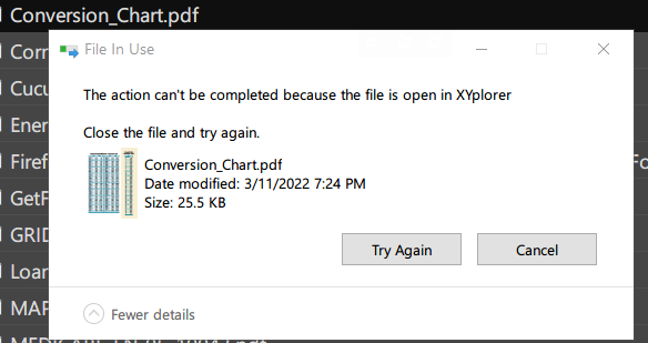

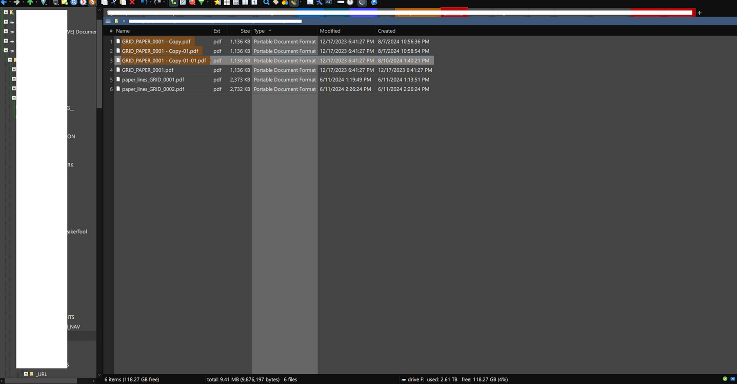

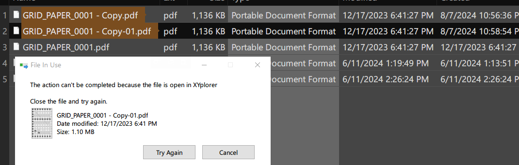

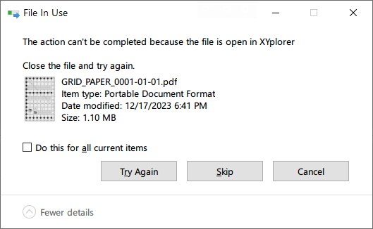

Tried deleting with current 25.50.0000 (30-Jan-2024) version. I created two new copies of GRID_PAPER_0001.pdf and attempted to delete the third then both the second and third. Seconds apart.
This is the error when attempting to delete from Explorer while XYplorer is still open. If I close out of XYplorer the files can be deleted.
Unsure if the ICO in the Windows dialog when deleting from XY and Explorer has anything to do with the issue or part of.

Posted: 05 Feb 2024 09:54
It's the standard icon for the "file in use" dialog in Windows 10/11.

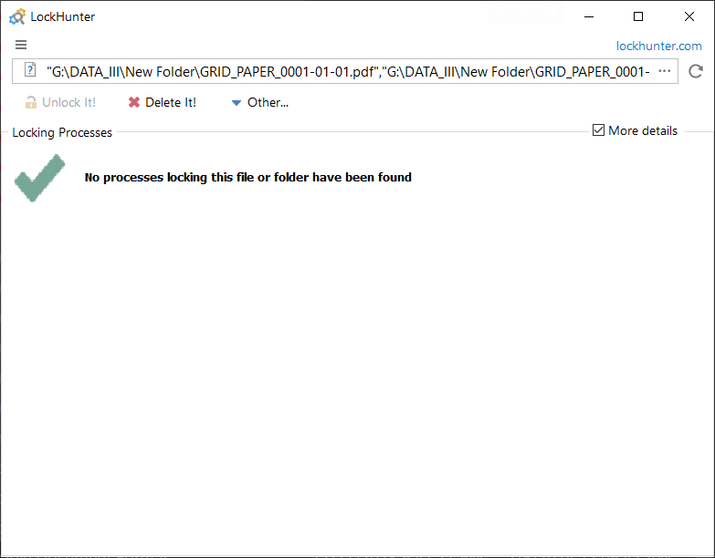

Posted: 08 Aug 2024 08:49
LockHunter still doesn't see anything?
Re: XYPlorer locking PDF files
Posted: 09 Aug 2024 23:19
by hawaii

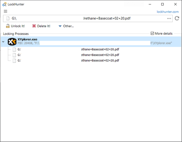

admin wrote: 08 Aug 2024 08:49 LockHunter still doesn't see anything?
I updated LockHunter, and initially, it didn’t detect anything. However, after a few attempts and keeping LockHunter open while refreshing the app while deleting, it eventually identified xyplorer.exe as the issue. Lockhunter did not produce any other information. I am unsure why it detected three instances of the PDF file while there is only one. I have not troubleshot it further than five minutes.

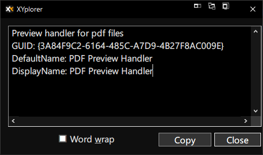

Thank you. Unfortunately I have nothing new to say. Closing the preview (and thus removing any locks) works 100% here (using PDF-XChange). Are you sure you're not using Adobe for previewing? You can check this by previewing a PDF and executing this script from the address bar:
text get("previewhandler");

admin wrote: 11 Aug 2024 08:57 This is returned WHILE a PDF is being previewed? :veryconfused:
I don't believe I had a PDF file selected then.
Here is the output I receive now.
Selected PDF file and the following message.
Entered string
Displays {3A84F9C2-6164-485C-A7D9-4B27F8AC009E}, else Micsoft Preview Handler
Changed from Microsoft Preview Hander to {DC6EFB56-9CFA-464D-8880-44885D7DC193} Adobe PDF Preview Handler
