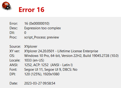

Posts: 3462
Re: Preview of some video files is not working
I am just recycling this topic thread, and this probably isn't important but thought it might be worth mentioning, I was just testing out the new SC preview, and on certain mkv (and to a lesser extent mp4) files I get Error 16 when using preview , te32; it seems to be larger files mainly 300mb+, sometimes it flashes up a proper preview image first, other times it doesn't, other times it is just a black box and no error message, I am only mentioning it since I thought it might be related to the PreviewEarly not working on some PCs and its state being ignored when using this cmd (I use non default =1). Since this is mainly a debug cmd it probably doesn't matter, but after that error occurs, MDBU broke for some files until I restarted XY, it reacted just like it does when I have default PreviewEarly=0 setting, busy cursor then nothing, thumbnails still worked though. (I have cache disabled), but normal preview pane/panel was then blank for all video files (only quartz), maybe that setting is remembered somehow for the rest of the session after that error comes up.

Posts: 66564
jupe wrote: 27 Mar 2023 01:43 ..., maybe that setting is remembered somehow for the rest of the session after that error comes up.
You got it, Sherlock. Fixed in next beta.
