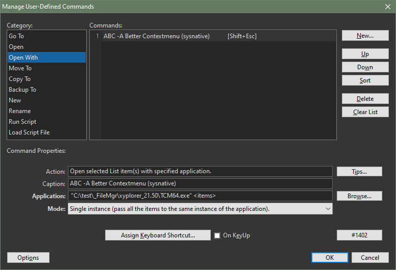

I replaced the 64-bit context menu of XYPlorer with a different one (because much faster and less missing entries) and had that same issue.
Can I ask how you did that and what you replaced the 64-bit context menu with?

nas8e9 wrote: 01 May 2021 17:54 Can I ask how you did that and what you replaced the 64-bit context menu with?
2021-05-01 19_23_35-Manage User-Defined Commands.png (18.28 KiB) Viewed 3331 times
Press SHIFT+ESC to open the 'alternative' contextmenu.
TCM64.exe can be downloaded here (source available too).
Especially with multiple filetypes, TCM gives better results.
It is *almost* an in-place upgrade of XY64ctxmenu.exe [1] if it were not for the way XYplorer.exe and XY64ctxmenu.exe communicate (a textfile with position and a list of files/fodlers is passed along)
[1] Make a backup copy of XY64ctxmenu.exe, save TCM64.exe as XY64ctxmenu.exe and open the 64-bit context menu to see what I mean. You can't actually use it though, just look.
