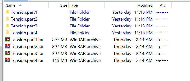

Hello, updated to latest beta and extract to separate folder works for various archives from various folders, however, encountered a bug where extracting now create 4 folders if the archive has 4 parts for example.
Attached a screenshot to see what I mean. Each new created folder includes complete files, resulting 4 folders with same content, instead of 1 with extracted files from all 4 parts

muciones wrote: 03 May 2021 01:17 Hello, updated to latest beta and extract to separate folder works for various archives from various folders, however, encountered a bug where extracting now create 4 folders if the archive has 4 parts for example.
If you mean that your rar archive is a multipart one and you drag and drop all parts
then I would expect that behaviour because WinRAR can't detect this condition.

Horst wrote: 03 May 2021 09:19
Hello, I am not using drag and drop, simply after selecting all found archives from various folders, I Extract to separate folder command that is in the new context menu added to beta version 21.70.0106

muciones wrote: 03 May 2021 09:26
Thats the same problem because WinRAR is invoked several times and can't detect this.
