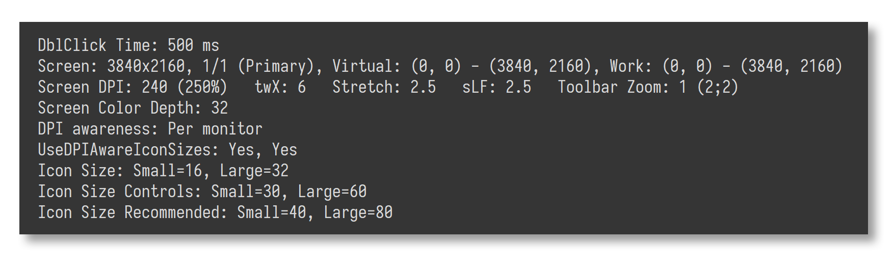

1) Please test the current beta version as a fresh instance. Is the default icon size okay? (I think so, your screenshot looks like 72x72 pixels buttons)
2) Please show a screenshot of the Help | Various Information dialog.

admin wrote: 16 Nov 2020 21:57 1) Please test the current beta version as a fresh instance. Is the default icon size okay? (I think so, your screenshot looks like 72x72 pixels buttons)
I installed the latest beta. Icons are still very small.
I opened the toolbar options, changed the setting to "Auto Size" (which is equal to extra large). Still very small:
Here is the graphics info in various information:
PS: Double icon in the upper left corner of the pop up is resolved.

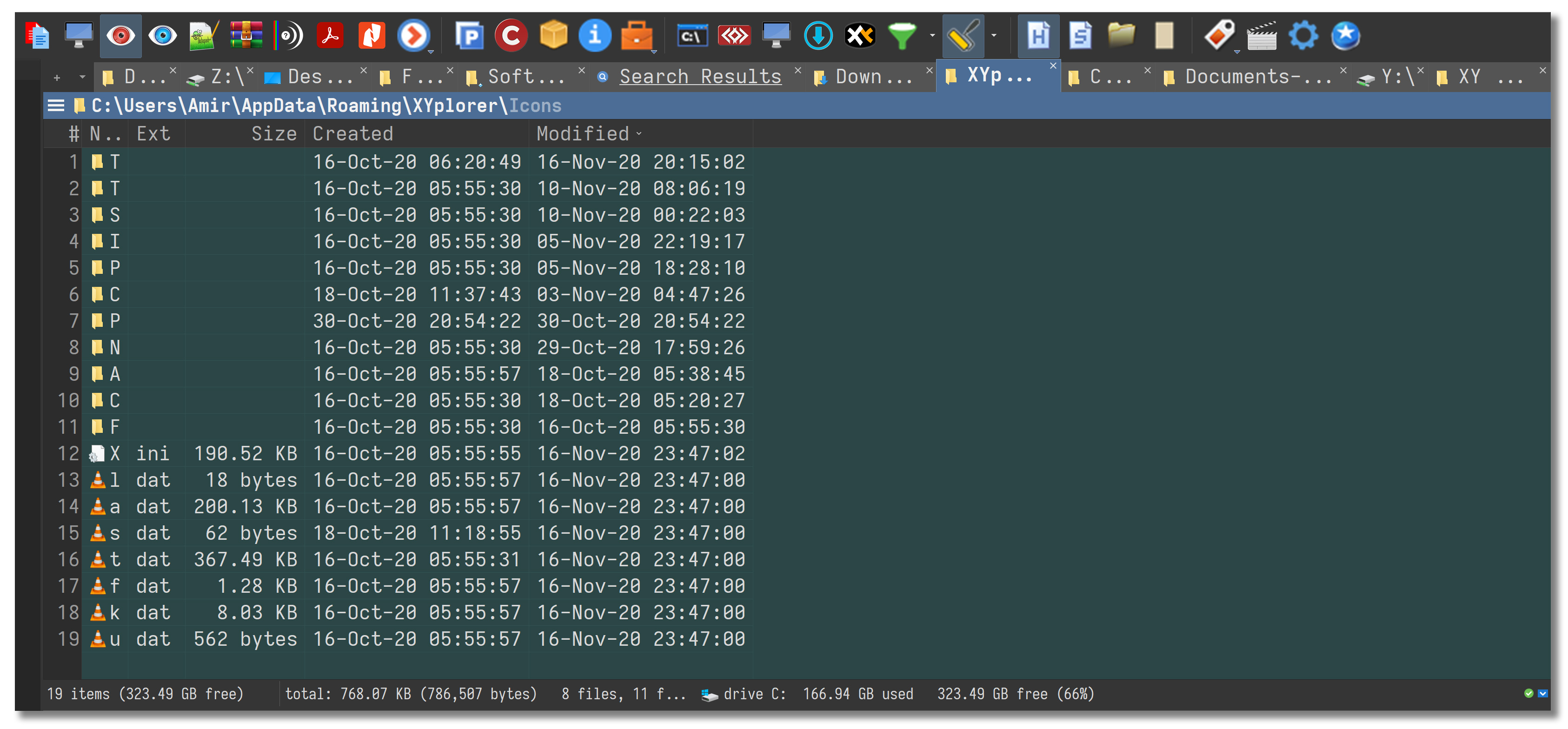

This is a snapshot of Full Size Graphical UI in 4k (3840x2160) in the latest beta.
I have enclosed the icons in different parts of the UI inside Red Boxes (except in toolbar). These icons need adjustments in size.
Actual size of "Vertical/Horizontal Gridlines" are visible exactly as is.
Toolbar is resized: ToolbarZoom=1.5. Toolbar icons are acceptable at this size.
PS:
I recommend downloading the full size photo and look it at full screen (which fills the whole 16x9 screens), to simulate what is currently seen in the actual 4k display.
Actual Sizes.jpg (1.77 MiB) Viewed 2291 times
