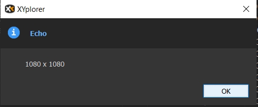

Posts: 65413
Re: size of pdf MDBU preview
In the next beta (v20.80.0101), do this:
echo get("mdbusize", "<your pdf file>");
or select the PDF file in the list and do this:
echo get("mdbusize");
Posts: 2054
Joined: 27 Jan 2005 23:38
Location: Cairns, Australia
Post by RalphM »
Probably not what you expected:
but looking like this:
Ralph :)
Posts: 65413
Well, it's a first step into knowledge...

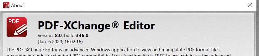

Posts: 2054
Post by RalphM »
My results:
GUID: {644D29FB-8692-49A6-B37D-D11A4CCC7A6D}
DefaultName: PDF-XChange PDF Thumbnail Handler
GUID: {9B68BDF7-95F9-4A1F-851C-27D822F8E3E9}
DefaultName: PDF-XChange Preview Handler
DisplayName: PDF-XChange Preview Handler
Apparently, neither the GUID's nor the names seem to match - for whatever reason.
Here again my installed version PDF XChange Editor:
Ralph :)
