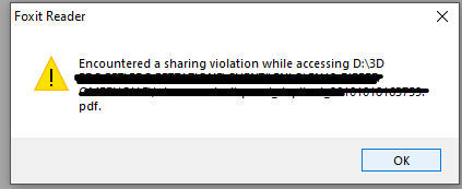

Post by Pablo4s »
i tried to install PDF XV, the thumbnails work !! perfect. But there is a small problem, I use FOXIT READER and when I try to open a PDF file I get this error ...and the file doesn't open..... edit>> the problem occurs only if the "single click to open an item" option is activated AND if the SHOW PREVIEW PANE is open.... With a double click everything works regularly....
Immagine 2021-02-18 152049.png (5.78 KiB) Viewed 1353 times
Posts: 65338
Re: PDF thumbnails... again
Try with the latest beta. Should work better now.
