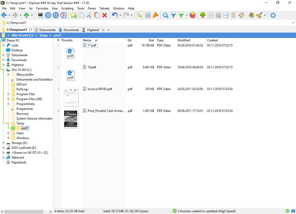

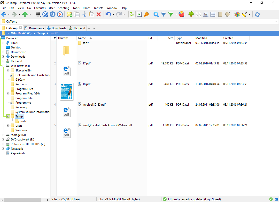

@Don, take a look at this:
Fresh Windows 10 RS1 (anniversary update) VM
v17.30 official XY (fresh), only one option changed
[ ] Cache thumbnails on disk
Sumatra 3.12 x64 installed and made the default pdf viewer
No other software at all is installed in this VM
The C:\Temp folder and C:\Temp\sort7 folder
contain exactly the same files!
View = Details with Thumbnails #1
XY shows in 1.png only a thumbnail for 18.pdf and it clearly
states that it only created 1 in the status bar
In 2.png I've switched to the sort7 subfolder
and now it created two thumbs and this time for
two other .pdf files while 18.pdf doesn't have a thumbnail
here anymore? oO
How is this possible?

Sumatra bug. I see no other possible explanation.highend wrote:@Don, take a look at this:
