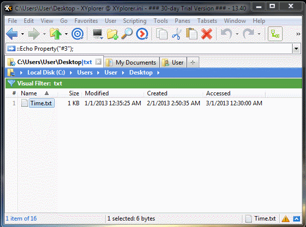

Here is a video of an interesting problem I noticed. Either XYplorer is caching the date value or the shell is. I split it into 2 parts due to file size. Part 1 is the walkthrough and Part 2 is after a quick restart of XYplorer.
Part 1 Part 2 - After Quick XYplorer Restart As you can see in the first one, even after the date and time is changed, XYplorer's Property("Write") [which relied on the shell] and Property("#3") did not correctly show the updated time even though XYplorer's property window AND Windows Explorer property dialog shows the updated time. After a quick restart of XYplorer, both XYplorer Property("Write") and Property("#3") now shows the correct updated time.

The shell is a "smart" layer between NTFS and the user. The Property() command asks the shell about certain file properties and dumbly reports what the shell spits out. It is only used in scripting because it is practical for the so-called "extended properties" which are not directly accessible by the API. Things like Modified Date however are core properties an XY internally always uses the API to retrieve these. You can use to come closer to the truth.
Now, since the shell (due to its smartness) also also relatively slow, XYplorer does a little caching here. And that's where the bug you saw, Enternal, is caused. Fix comes...

Yeah! That little caching bug is now gone! Works perfect in that area.
Haha, yes I have already been using Report() as an alternative since it does exactly what I want. It's just that Property() left me a nagging question about why does Window did what it did. So now I understand how it works more. So basically the shell is somewhat of an independent system from what Windows Explorer does and as a result, there is a bit of a difference in how information are obtained.
