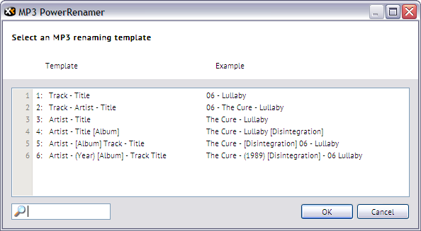

Here's a (quickly rearranged) script I use just for that purpose.
### MP3 Power Renamer ###
Description:
- Rename your MP3s based on their tags, and by choosing a template
Important:
- it processes MP3s only (didn't test it with something else)
- MP3s must be tagged (else it won't touch the files)
- the property numbers for IDtags (e.g #10 for "Title") may differ depending on your OS
Notes:
- templates can easily be added or changed
- it renames a whole folder if nothing is selected, or only selected files
- to rename several folders in one go, switch to Branch view and select all files
- files are renamed directly by the script
- but the script copies to the clipboard the full list of new names, so if you'd rather rename and preview the whole by yourself, just comment out/in 2 lines in the script, then run the script which will open "Files | Rename Special | Edit Item Names...", then select all and CTRL+V (this can't be done via scripting).
- don't forget: in any case, XYplorer's Undo is very efficient!
Last note:
It's working great here, but only tested under WinXP, so your mileage may vary... ;)
I provide it as-is in case it might be useful... but it's not specially optimized and could be largely enhanced (it depends if someone's interested).
Hope this helps, 8)
Flux

	$Template_List = <<<#>>>
1:   Track - Title<tab 4>06 - Lullaby
2:   Track - Artist - Title<tab 3>06 - The Cure - Lullaby
3:   Artist - Title<tab 4>The Cure - Lullaby
4:   Artist - Title [Album]<tab 3>The Cure - Lullaby [Disintegration]
5:   Artist - [Album] Track - Title<tab 2>The Cure - [Disintegration] 06 - Lullaby
6:   Artist - (Year) [Album] - Track Title<tab 2>The Cure - (1989) [Disintegration] - 06 Lullaby
// ------------------------------------------------------<>   Template selection
	$Template = inputselect("Select an MP3 renaming template<crlf 2><tab>Template<tab 5>Example", trim($Template_List, "<crlf><tab>"), "<crlf>", 0, , , , "MP3 PowerRenamer");
	$Template = "$Template_".gettoken($Template, "1", ":");

FluxTorpedoe wrote:Hi'
So in any case, the best approach is to ensure everything's tagged correctly first.
In my case, I'm reasonably confident of it. I always try to ensure stuff's properly tagged simply because MediaMonkey and my MP3 players pay a lot more attention to tags than filenames. It's one of the reasons my filenames are all over the place, because over the years I've used all sorts of naming strategies. And generally I've never worried about having the track number in the filename because my MP3 players read it from the tag. Sometimes I've even deliberately renamed things that DID have the track number in the filename just so it looked better in a file list.
The main problem I'm trying to resolve is a direct result of the fact that my wife's MP3 player has the facility for an expansion SDHC card BUT the contents of that card don't get added to the player's library. So the only way to get albums to play in track order if they're being played from the card is to ensure that an alphabetic sort by filename is the equivalent of a track number sort by tag. And having decided on a strategy, I want to use it across my whole collection, just for tidiness, and because, who knows, my wife might suddenly develop a taste for something it never occurred to me she might like. :)
Of course, if you only need to rename one album, it's much easier to do it from your tagging soft.
Nope. Lots of albums. Hundreds. (I have a 40Gb MP3 player and it doesn't hold all the music I have. I also have many CDs I have yet to get around to ripping.)
I'm comfortable working through them one at a time -- I don't want to find out in a fortnight that I've broken something by accident, through making a few unwarranted assumptions -- but a single button rename to the naming strategy I want is a LOT easier than, well, anything more complicated. :)
I'll give it a try -- many thanks!
I can't imagine it'll be very different under Vista or 7 but I'll test carefully :)
I'm more likely to strip it back so it doesn't ask me anything, but my first step's going to be understanding what you've done and how you've done it so I can avoid stripping anything out I actually need :)
Thanks again -- it looks brilliant!

Color me stupid, but can you point me in the right direction? (Actually, MP3Tag does this easily, but I'm now challenged because it's my firm belief that XY can do ANYTHING with a file! Sorry, Don, that's your fault!!! :lol: :appl: :appl: )

Post by GUIguy »
BINGO!
Even I was able to figure it out. (Still your fault, Don! :lol: :appl: )
