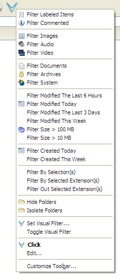

Here's a script for a Custom Toolbar Button (CTB).
• Left Click (LC): Power Reset
=> Reset view (reset filters, view type, columns, sorting...)
• Right Click (RC): Power Filter
=> Opens a menu of filtering options

••• Right Click (RC) - Filters •••
• The first "Filter Labeled Items" has two functions:
- If no item (or a non labeled item) is selected, then it will filter the view to (only) show all labeled items
- If a labeled item is selected, then it will filter the view to (only) show same-label items
=> If you want to filter only specific labels, you can change or add selfilter lines. For example, I left the one I use with "(" (my main color labels have parenthesis in their name), and I added the second selfilter with "e" (by default, all color label names contain "e").
• By personal preference, the "Filter Modified..." or "Filter Created..." are based on hours - so "Modified Today" means "Modified during the last 24 hours".
• By default, filtering by Date (modified or created) won't will change the view and sorting.
=> To leave the view and sorting untouched, change the header of the script by setting to "0" the tweak: $GEN_DateViewSort
• By default, filtering by Label will be sorted by Label.
=> To leave the Sorting untouched, change the header of the script by setting to "0" the tweak: $GEN_LabelSort
• To force all filters by item types (Images, Audio, Video, Documents, Archives, System) to be sorted by Extension, change the header of the script by setting to "1" the tweak: $GEN_TypeSort
• To force the filter by Images to be displayed unchanged or in one of the 3 Thumbnails View, change the header of the script by setting to "0", "1", "2" or "3" the tweak: $GEN_ImgView
• To force the other filters by item types (Audio, Video, Documents, Archives, System - plus Label) to be displayed in Details or List view, change the header of the script by setting to "1" or "2" the tweak: $GEN_OthersView

Please, add icons.
There they are too! Including some that are used in other related scripts (that may come one day...).
I couldn't automate icon detection (cause it's not a dynamic menu), and I didn't feel like updating two versions each time, so you'll have to do a little manual work! :wink:
