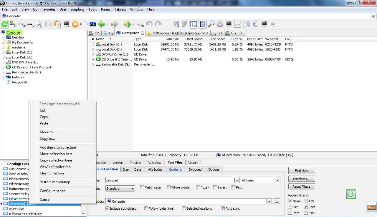

i am using the catalog to run the teracopy.xys script. it is working with the 32 bit and 64 bit systems. recently i have bough one win7 64 bit dell xys inspiron 7. i have installed teracopy 2.2 on my system. from catalogue, the xyplorer options are popping up, the moment i click the script, but teracopy window is not popping up while copying or moving files.

Re: TeraCopy Integration
Three things to check would be:kotlmg wrote:i am using the catalog to run the teracopy.xys script. it is working with the 32 bit and 64 bit systems. recently i have bough one win7 64 bit dell xys inspiron 7. i have installed teracopy 2.2 on my system. from catalogue, the xyplorer options are popping up, the moment i click the script, but teracopy window is not popping up while copying or moving files.
1. does TeraCopy work at all, e.g. when called from Windows Explorer;
2. is the path to TeraCopy.exe correctly defined (I'm aware you said you checked already) by way of either an explicit path (C:\Program Files\TeraCopy\TeraCopy.exe) or through the %ProgramW6432% variable (instead of the %ProgramFiles% variable, which resolves wrongly when used by a 32-bit app);
3. did you create an empty folder for the script to store its lists in (e.g. scripts\TeraCopy)?
1.the teracopy works perfectly with explorer.
2. i have used ProgramW6432% variable instead of the %ProgramFiles% variable and it is working like a charm with xyplorer.
your second tip worked for me. thanks a lot for solving my problem patiently.

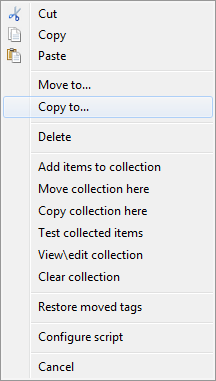

This script is very useful.
If you can add some icons before each menu item, it will be more user friendly.
I made minor changes as follow:
Please see menu in the attachment.
Left file: \teracopy 7.2.xys
Right file: \teracopy 7.2 edited.xys
51c51
< "Cut : cut"
> "Cut |:cut : cut "
57c57
< "Copy : copy"
> "Copy |:copy : copy"
63c63
< "Paste : paste"
> "Paste |:paste : paste"Please see menu in the attachment.
- teracopy menu.png (9.4 KiB) Viewed 9398 times
