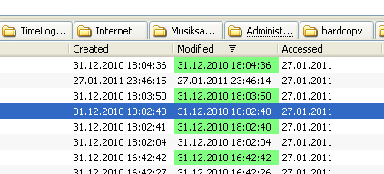

Edit: Could it be that you broke something in the logic of sorting by adding this?
(See the 2nd item in that screenshot - no manual sorting)
Ralph :)

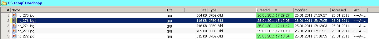

RalphM wrote:Edit: Could it be that you broke something in the logic of sorting by adding this?
Are these files or folders?

Oops, sorry, cropped the image too much for you to tell. :oops:
These are all jpeg images and no folders - otherwise I agree it would be possible...
Ralph :)

Can you post the whole list (all columns) so that I can see what's going on?

Edit: I could reproduce it on my work machine too and it seems that it always affects the first two files in the list only and only if the sort order is descending, see following screenshots...

So you are saying the files' order is not correct when "Sort folders always ascending" is checked? I cannot repro this problem.
Ah, got it! There is indeed a bug when there are no folders at all in the listing! Fix comes... :D

Yep, seems you squashed that bug, thanks
