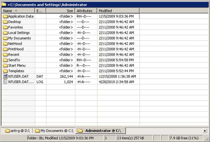

I am sure you have seen how [xplorer²] handles that. It's nice that they have tabs on the bottom, and address bar on top. You could probably do the same thing, and make it an option.
I attached a screen snippet from [xplorer²]

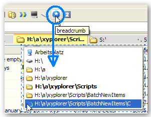

maybe try this (at least as an work around):
- go to an min. 6 folders deep sub-folder
- go up two folders
- press shortcut Ctrl+Backspace
What's new in 5.20?
Released 16-Oct-2006
Revolutionary keyboard-driven popup-Breadcrumb.Idea:
Maybe this dialog could pop-up on an double-click (or Ctrl+Click) at an list tab.

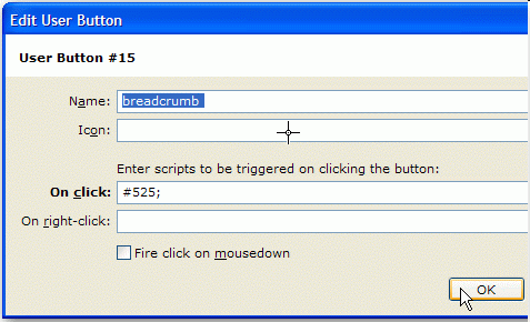

Or, just tested: we can add an Tool bar button (CTB) with command #525; for that issue.

you can also get the breadcrumb for a tab by right-clicking the tab's icon.
