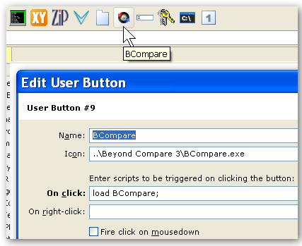

Here i have done an try to integrate "Beyond Compare" (or WinMerge) as comparing tool into my XYplorer setup:
1.) save the "BCompare.xys" from below into an plain text file named "BCompare.xys" in your XYplorer\Scripts -folder
2.) to launch that script you have several possibilities, e.g. adding an new toolbar button:
3.) If you launch the script you will see an new dialog popping up:
Just click at an item to launch BeyondCompare with the selected files/folders as parameter.
(Note: just modify the "_Execute" section to launch an other application like WinMerge)

How to use:
	1.) Copy the script below in an file "..\scripts\BCompare.xys".
	2.) Then, e.g., add an CTB toolbar button:
		Icon: path\to\Beyond Compare 3\BCompare.exe
		On Click: load BCompare;
	3.) Select two files or folders in XY.
	4.) execute this script.
	5.) you are prompted with an menu
