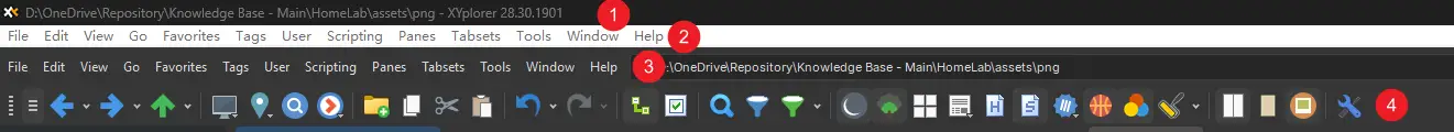

I am using XYplorer version 28.30.1901 (64-bit). If I recall correctly, ever since the 32-bit era, XYplorer has featured a custom-developed menu bar that coexists with the native system menu bar (note: I am referring to the menu bar, not the toolbar).
The native system menu bar does not support Dark Mode, so it looks out of place. I have researched this extensively, but the available settings only allow control over XYplorer's custom menu bar. Since the functionality of both menu bars is identical, I see no need to keep the native system menu bar.
Is there any way to disable the native system menu bar?

There seems to be some misunderstanding. I am referring to the repetition of items 2 and 3 in the image below.

Are you saying your row labeled "2" does not toggle with CID #1061 or the keyboard shortcut for "Toggle Main Menu" as we discussed above? If that's the case, I'm not sure why it's white when you are in "Dark" mode.
If you click on the toolbar item with the 3 short horizontal lines which is "Show Menu Bar" (your 2nd toolbar item from the left side), what happens? does the row labeled "2" in your picture toggle?
Other possibility (less likely), you may have listed in "Customize Toolbar...", "All menus (Group)" twice, one in row 1, and one in row 2. You can have multiple "rows" in each toolbar and have the "All menus (Group)" in each row. Go into Customize Toolbar and look at the right side panel which lists the items. You may see "All menus (Group)" listed twice one row 1 and one in row 2, You would also see an entries for New Row. I was thinking your #2 row was XYplorer's Main Menu which can be toggled on and off as I described above, but the menu items on that row as shown in your picture do not have the accelerator key underlined (they are underlined on my Main Menu if/when I have it shown).

I've tried every method I could find, including the Ctrl+Shift+Alt+F12 shortcut, Ctrl+Right-Click, and the #1061 command, but I can't turn off Bar-2; I can only control Bar-3.
I purchased XYplorer in January 2019 and started using it. Due to the passage of time, I can't guarantee the accuracy of the following information:
XYplorer already supported dark mode in 2019, and there was always a Bar-2 version that didn't support dark mode. It seems that XYplorer released Bar-3 in 2021, coexisting with Bar-2.
Bar-3 has the same menu options as Bar-2, with only three differences:
1. Dark mode support
2. Can be toggled on/off
3. Can be interacted with via the right mouse button
