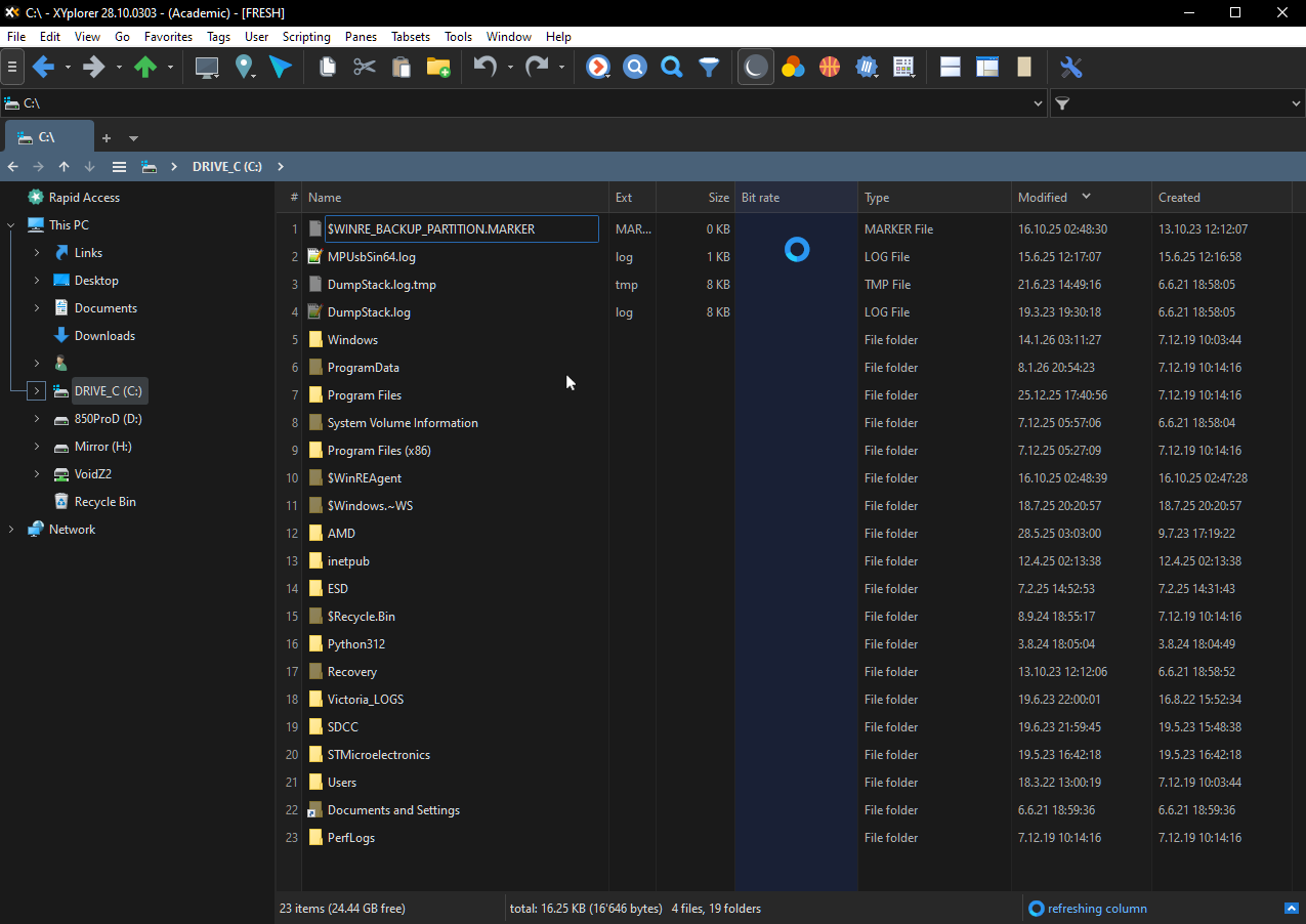

Alright, hearing that slow columns can be problematic made it easier to capture the bug.
I made a test folder with some files and started a batch script that renames "test.txt" to "test.bat" and back. The recorded GIFs are best viewed with a video player like MPC-HC, frame by frame with Ctrl+Right/Left (VLC does not play the GIF).
In the first GIF, I have the slow column Custom size circles visible, and renaming happens every 5 seconds.
I mark "test_158.txt" and keep Ctrl pressed. Just when the batch renaming triggers a list refresh, I right-click "test_152.txt". File "test_152.txt", under the cursor, gets replaced by "test_009.zip", and the context menu shows up afterwards. Still keeping Ctrl pressed, I left-click "test_024.zip". In that moment, "test_024.zip" turns into "test_010.zip". Once the re-sorting is finished, I am unaware that "test_010.zip" got selected because that file is off screen. I release the Ctrl key and right-click "test_152.txt", but nothing happens because of another list refresh. The second right-click and delete on "test_152.txt" reveals that not one but two files were selected.
In the second GIF, I removed the slow column and renaming happens every second. The file sorting bug is not present, but XYplorer doesn't register mouse clicks when a list refresh is happening. I this a separate second bug?
It can be argued that slow columns come with a drawback. But the list was sorted by Modified, not by the slow Circle size. Does XYplorer not sort by Modified first, and then calculate and draw the size circles?
I noticed that the two wrongly placed files "test_009.zip" and "test_010.zip" were at positions 5 and 6 in the list. These are their positions in the list when it is sorted by Name!
Maybe triggering a list refresh sorts it by Name internally first, before the list gets sorted by the selected column and redrawn. When users interact with the list during a refresh, the wrong files can be selected and XYplorer briefly draws the internally sorted file. This does happen sometimes without interactions, where it doesn't cause trouble, but it is visible.

Thanks! Could you also send your XYplorer.ini to support. I have to reproduce the auto-refresh settings exactly.

Yep, I can see it now. The only solution is a radical block: no clicks or keys while the list isn't completely loaded and sorted. Next beta (32/64).
