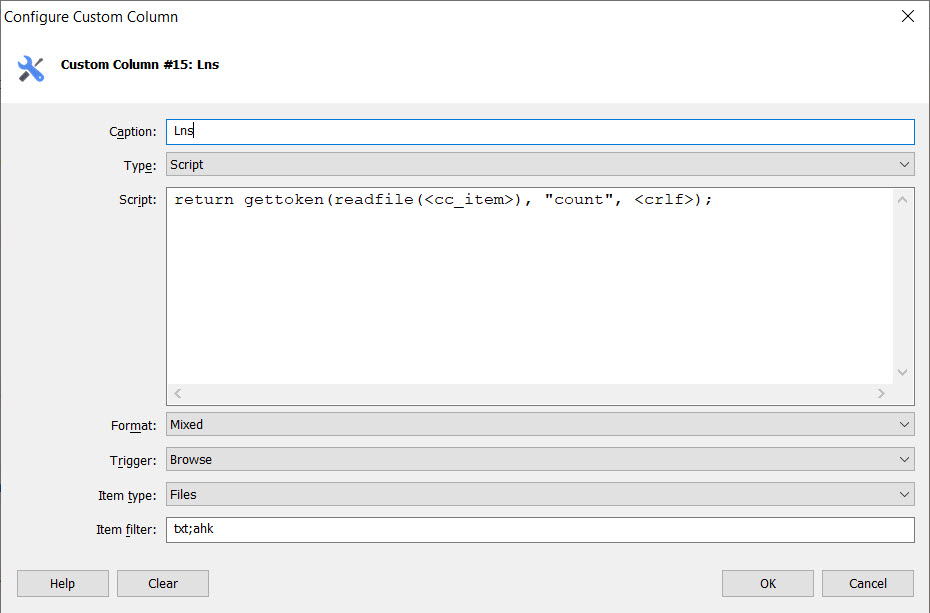

Thanks Highend! Below is the setup, if anyone is curious.
Also a follow up question: Is it possible to append a bit of text to the end, when there is a value returned? So that it will show up as, for example
234 Lns.
CC 2026-01-08_14-11-48.jpg (78.6 KiB) Viewed 408 times
ste(phen|ve) kunkel
Posts: 14672
Re: Column question: Lines of text in a text file?
Concatenate it?
. " Lns.";
