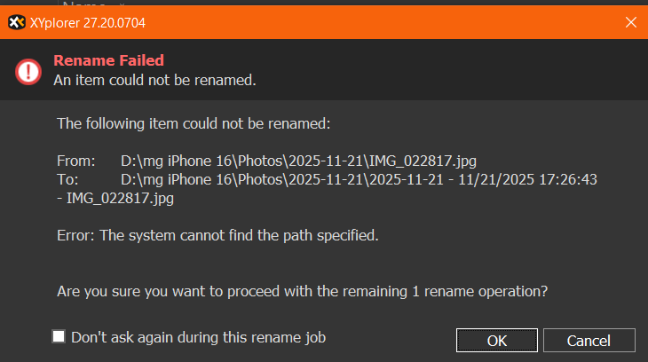

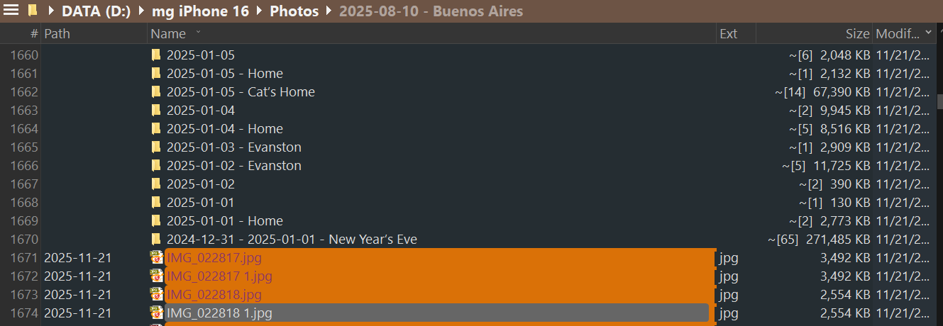

I have a group of folders where the "top" one is a date, or a date plus a name, and photos inside. I turned on branch view (see screengrab), selected a few, and tried the following rename special: <folder> - <datec> - *
The preview shows me that it will work as desired (see screengrab), but when select rename now, it gives me an error message for each of the selected files.
What am I doing wrong?
Any assistance would be greatly appreciated.
Rename Special & Branch view & Failure

: in paths / file names are not allowed (apart from the first one after a drive letter), hence it failsOne of my scripts helped you out? Please donate via Paypal

You guys are talking over my head.
I added the "-" (no quotes!) where you indicated.
Does not seem to make any difference. Same error message...
