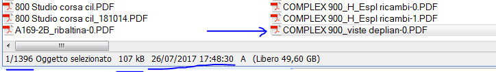

it would be useful to add the main file properties in the status bar, as most other explorers do, for example, size, last save date, file type.

Pablo4s
- Posts: 30
- Joined: 04 Jul 2018 15:11
Re: Add properties of selected file in the status bar

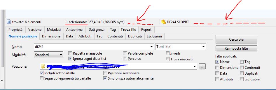

Thanks Jupe, I have already found and configured everything you told me, I'll explain better with photos ... The info panel is very useful, but in its minimum size, sometimes it is still too large, moreover you have to switch between the various tabs ...jupe wrote:You probably already realize this, if so just ignore me, but you can open the info panel to see all that information (Ctrl+1) on the Properties tab, also File Info Tips can display it on mouse hover, you can even choose what you want to see via,
