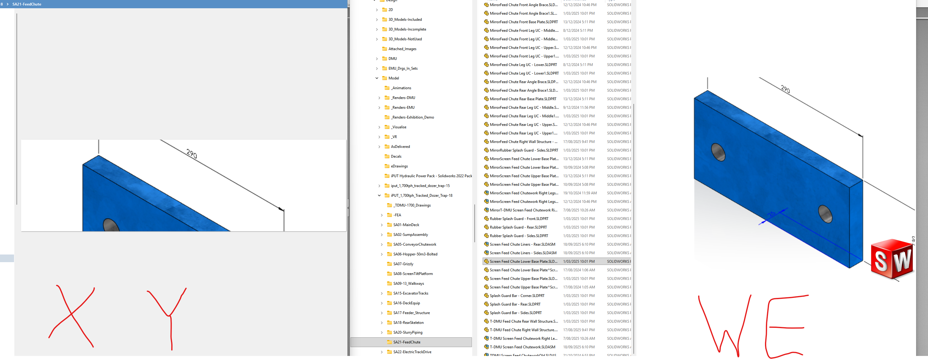

Within hours of the last post I bought a PDF-XChange Pro licence and completely obliterated Acrobat and some weird Adobe thing from my PC; used Revo Uninstaller Pro to be sure, and still found Adobe dregs in data directories, all gone. Not a single XY crash / winkout ever since. Was it an XY-Adobe thing, or that I was using old software and deserved whatever arcane incompatibilities that threw my way...?
I see my narky little Solidworks 1/3 height previewing issue has persisted through many a 32bit updates of XY, maybe it goes away in 64bit? A pic of a few mins ago; hoping this one can get some attention in the transition:
Having opened WE next to XY, all I need to do is click a different file in XY, see the third-height preview for that one, and click back to the illustrated one and it is now at the same display height and appearance as WE. No other actions needed. Repeatable ad-nauseum.

These previews are cached by File Explorer, and XY reads that cache, that's why XY does it right after FE does it.
Why not try the latest 64-bit version right away?

OK, put the latest 64 bit version on, still same 1/3 height previews of Solidworks files. Will pester more when the initial flood to get the main user base on 64 passes...
