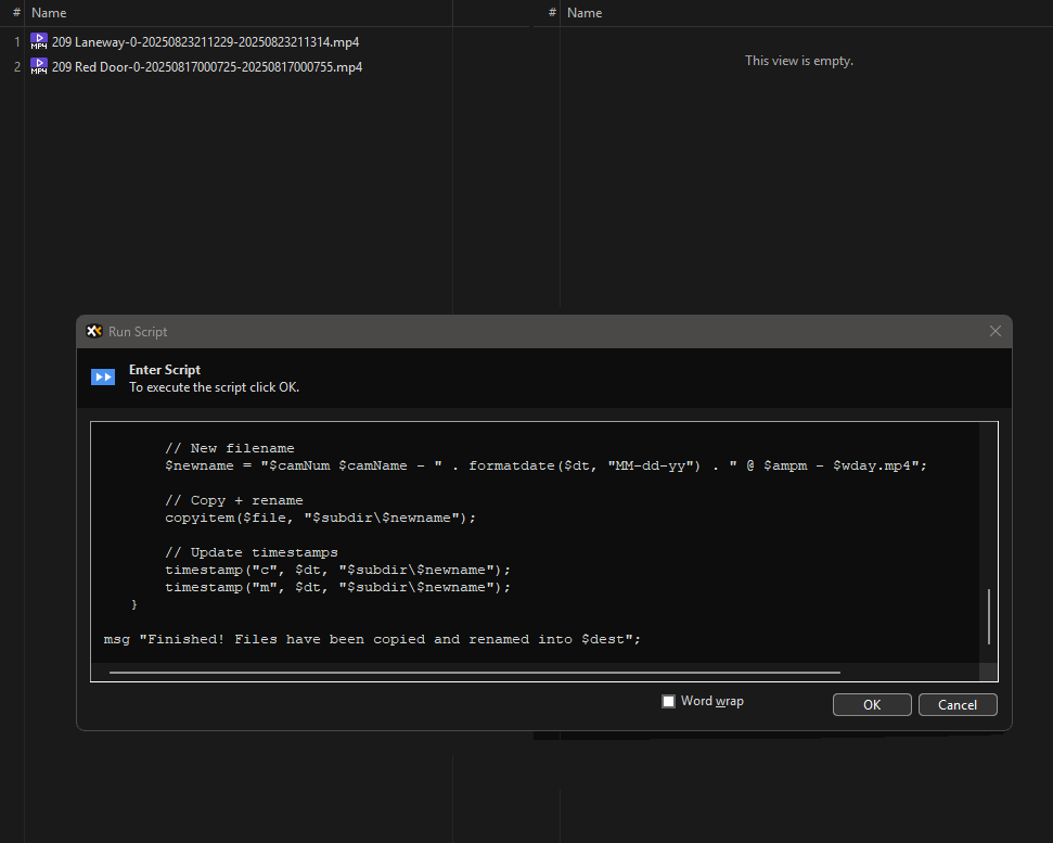

For complex scripts like this, the AI can usually give you a script that doesn't work, but you can consult the help documentation and provide feedback to fix it.
For reference only:
For reference only:
// === CONFIG ===
$src = "G:\Reolink\Reolink_Downloads"; // Root folder to search
$dest = "J:\"; // Base destination folder
// === PROCESS FILES FOUND BY QUICKSEARCH ===
// Find all mp4 files recursively in $src
foreach($file, quicksearch("*.mp4 /r", $src), <crlf>) {
if (exists($file) == 2) {continue} // skip if not a file
$name = gpc($file, "file");
// Split parts by "-"
$part1 = gettoken($name, 1, "-"); // "209 Red Door"
$part3 = gettoken($name, 3, "-"); // "20250817000725" (timestamp)
// Camera number and name
$camNum = gettoken($part1, 1, " "); // 209
$camName = trim(substr($part1, strlen($camNum)+1)); // Red Door / Laneway
// Timestamp
$yyyy = substr($part3, 0, 4);
$mm = substr($part3, 4, 2);
$dd = substr($part3, 6, 2);
$hh = substr($part3, 8, 2);
$mi = substr($part3, 10, 2);
$ss = substr($part3, 12, 2);
$dt = "$yyyy-$mm-$dd $hh:$mi:$ss";
$wday = formatdate($dt, "dddd"); // Day of week
//$ampm = formatdate($dt, "hh.nn.ss tt"); // 12-hour format
if ($hh < 12) {$ampm = formatdate($dt, "hh.nn.ss") . " AM"} else {$ampm = formatdate($dt, "hh.nn.ss") . " PM"}
// Destination subfolder
$subdir = $dest . "\" . $camName . " Video (209)\$yyyy-$mm-$dd - $wday";
if !(exists($subdir)) { new($subdir, "dir"); }
// New filename
$newname = "$camNum $camName - " . formatdate($dt, "MM-dd-yy") . " @ $ampm - $wday.mp4";
// Copy + rename
copyitem($file, "$subdir\$newname");
// Update timestamps
timestamp("c", $dt, "$subdir\$newname");
timestamp("m", $dt, "$subdir\$newname");
msg "Finished! Files have been copied and renamed into $dest";Windows 11 24H2 @100% 2560x1440

Thanks Norm for this "For Reference Only" script but unfortunately I don't have enough knowledge to make it work through to completion where it simply works. I tried as is just to see what happens and get I popups to confirm each file one by one then time stamping errors and then clicking on okay, nothing happens despite the final popup saying the files have been copied and renamed into J:\
Anyway, if you or anyone knows how to make it work through to completion then please help.

I didn't add any checks in the code, but it works here.Schuller wrote: ↑26 Aug 2025 16:32 Thanks Norm for this "For Reference Only" script but unfortunately I don't have enough knowledge to make it work through to completion where it simply works. I tried as is just to see what happens and get I popups to confirm each file one by one then time stamping errors and then clicking on okay, nothing happens despite the final popup saying the files have been copied and renamed into J:\

$place = gettoken($part1, 2, " ", "t", 2); // Laneway
- Posts: 15016
Re: Need a script please..
Again, thanks for the donation
