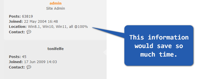

You've been here for 16 years now, you have a problem with the display of a specific monitor, and you don't even specify the screen resolution? What's been going on lately? Is it the summer (the twinBASIC forum has also been going downhill recently)? I'm tired of pulling the worms out of everyone's noses.
I also asked thousands of times to add this little line to the profile (see screenshot). But no, almost nobody cares.

First of all: thanks for using the Location field in your profile. Finally someone listens!
I'm sure the multi monitor issues will be solved in the 64-bit version, but as you guessed they are not the first priority right now. Thanks for your patience!
